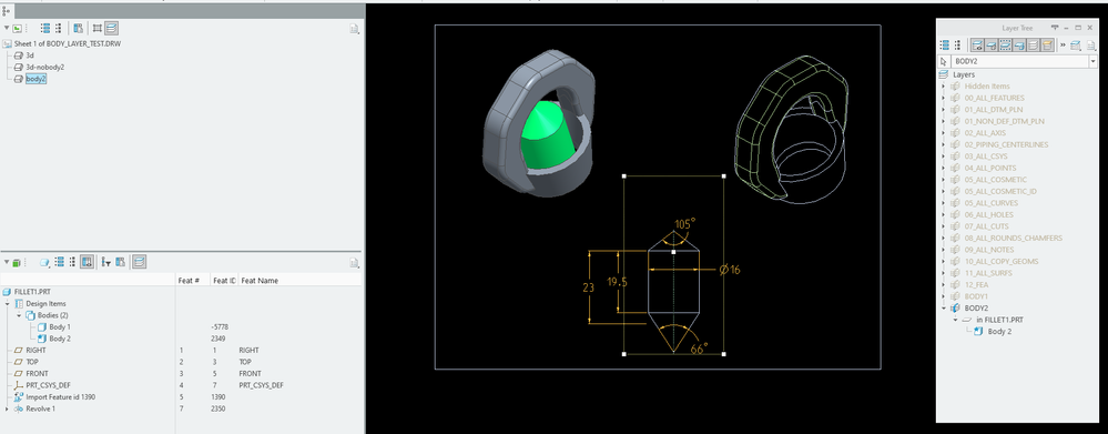

I have a multibody part (prt0001) that is a clam shell design containing two bodies. I want to create two drawings - one of one half of the part (Body 1), and one for the other half (Body 2).
Any solutions that I haven't tried below would be much appreciated! Thank you in advance 🙂
I attached the part and drawing I am referencing below.
I have some solutions, but none of them are exactly what I want:
1. Create a new part that references the Body in prt0001. (This is less than ideal because you cannot bring in any dimensions from the original part. All dimensions must be manually placed, which is a lot of unnecessary work).
2. Create two drawings for prt0001 containing both bodies. Hide all bodies you don't want to see when you are ready to export. (However, this stinks because the user needs to remember to hide other bodies, and then hide other bodies in the model. Far less than ideal, especially if you are working on both parts at one time).
3. I tried using Combined States on the drawing, but this doesn't work. I have a video of what happens below.
Thanks again,
Jeff Houston
pausob
(To:JiffiPop)
My 2 cents: I think you can use layers and create the drawing containing only the master model.
Put the bodies on separate layers and then hide as needed - this can be done on a per-view basis...

So, instead of creating a child copy from one body of the master model, I could create multiple drawings that represent the master model. However, if I do this, I am unsure how to hide certain bodies and KEEP them hidden in the drawing (regardless of what is hidden/shown in the 3D part).
pausob
(To:JiffiPop)
JiffiPop
(To:pausob)
This is a great suggestion - I think this will do what I want to do. I am not very familiar with capabilities of hiding/showing layers on particular views, but I think I can figure it out. I will follow up in the next couple of days. Thanks!
JiffiPop
(To:pausob)
Hi, this looks to be a great solution! I made a layer for each individual body in the master model. Now, in each drawing, I can hide the undesired bodies as needed. Thank you!
