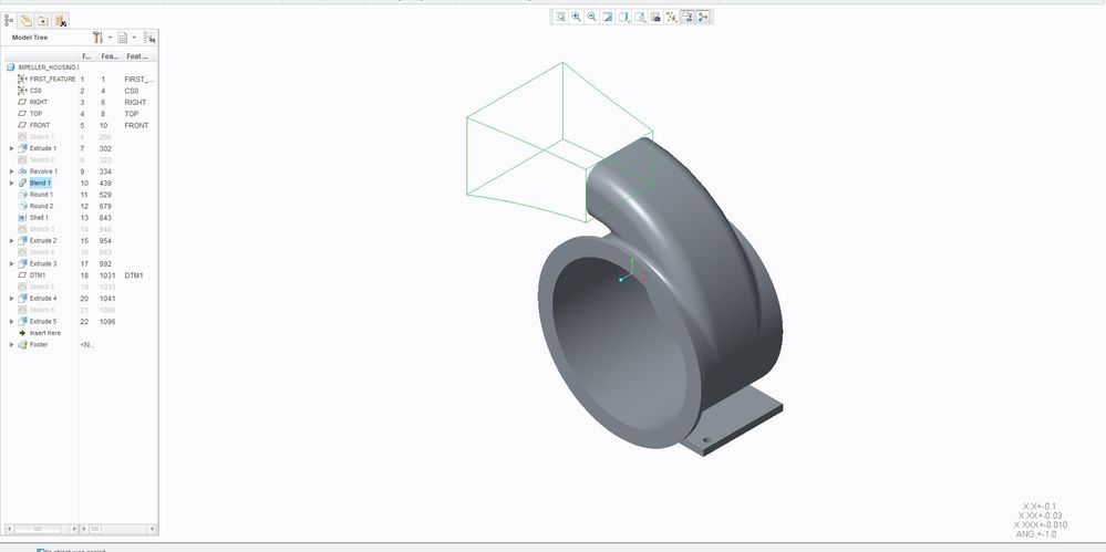

I made a blend with 2 sections, it says it generated successfully, but then when I move onto the next step of trying to create rounds on the edges, the blended part I just created doesn't appear for me to select? What do I do?
4 REPLIES 4
Did you Create the blend as solid or surface?
also check if solid layer is hidden by any chance.
@juanalzate
Can you share the part? By any chance, is it at assembly level? Or part level
I can't share the file itself since it was made on a work computer. But here is a picture of what I see the blend. I can see the outline, but not the actual 3D model of it itself. Capture.JPG
@juanalzate
Check feature type, is it surface and also layers in part, possible it is surface and hidden in layer.
