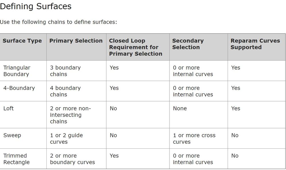

BHOoi
(To:bbrejcha)
Hi, Bart Brejcha.
I only realized style surface has this capability very recently. I would like to learn more but i failed to find any documentation on this. Could you please help me out? Many thanks in advance
bbrejcha
(To:BHOoi)
send me your model bart@designengine.com
Bart Brejcha
Design-engine.com
BHOoi
(To:bbrejcha)
Hi, thanks for the reply.
I am actually looking for the documentation of style surface built with > 4 edges. I don't see any explanation on this on the user guide.
BHOoi
(To:bbrejcha)
I fount this in help, but never mention about > 4 edges.
