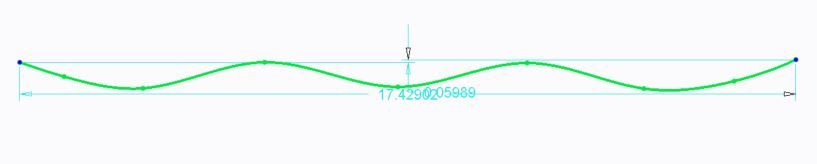

I am needing to build a sketch that the curve needs to follow an exact pattern.  I have attached a sketch that shows the basic curvature. (As it is freehand the shape is not exact however)
The pattern of curvature needs to follow a point placement like this.  The initial point is at X=0 and Y=+.06.  The second point on the curve would be X=+.5 and Y=-.06.  The 3rd point on the curve would be X=1 and Y=.06.  Etc...
I want to build a curve where I don't have to manually enter the dimensions as the size will extend for close to 50 inches.

John.Pryal
(To:Roy_Crerar)
Subsitute 'sin' for 'cos' in the formula & you get another variation of the curve.
Worth a mention.

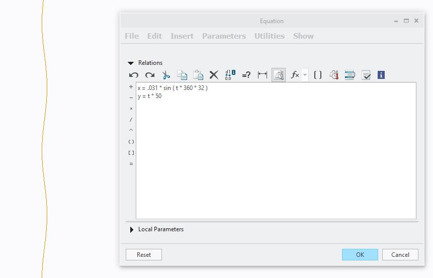

(To:Roy_Crerar)
rcrerar:  Here is the formula that I went with.  This worked great.
I will be able to use this pattern in the straight stretches, but unfortunately I can not use this for twisting around a large radii in our die.  With that I will be developing a different technique involving a pattern and some fillets.

John.Pryal
(To:pimm)
"I will be able to use this pattern in the straight stretches, but unfortunately I can not use this for twisting around a large radii in our die.  With that I will be developing a different technique involving a pattern and some fillets."
I am not sure what you mean exactly by your statement but would the attached image help?
pimm
(To:John.Pryal)
John:  Your example does place the general inclination of the curvature we are after.  Unfortunately the inclination needed is not 90 degrees as in your example, but 72 degrees.  The long linear portion that we would use gets tilted that amount through the tilted CSYS.
