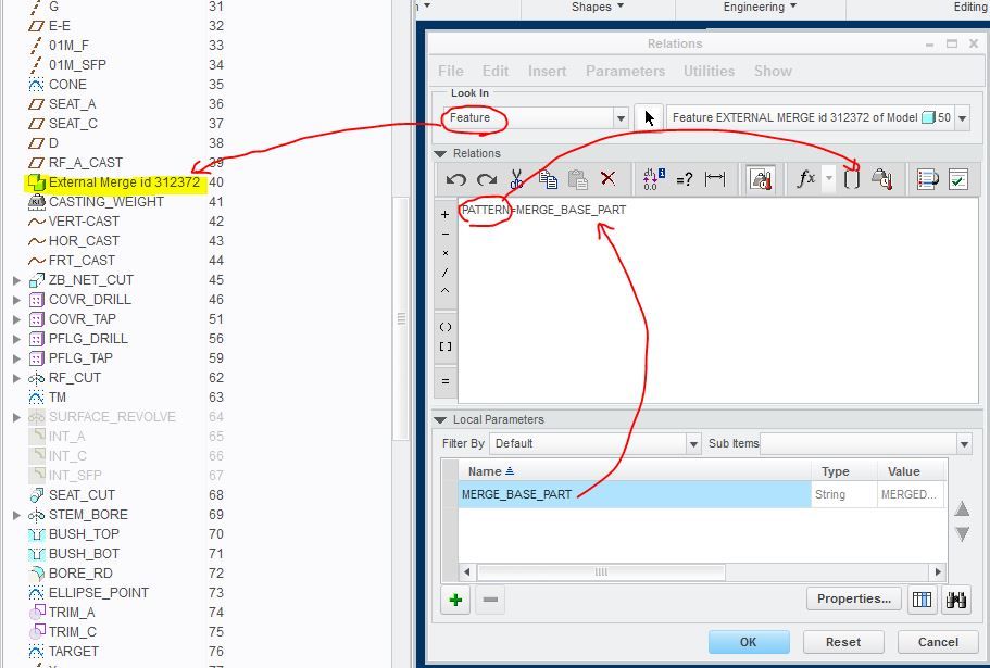

ptc-4972245
(To:pimm)
you can use relation/feature
on merged part:
merge= merge_base_part
(merge_base_part is a local parameter)
note: create parameter "merge" before writing the relation.
it will take the file name.
pimm
(To:ptc-4972245)
ptc-4972245:  The 1st question that I would have towards this is whether this would be replicated with every part that was inserted as merge/inheritance?
I am not familiar with writing relations.  If this is possible for every part that would be inserted could you possibly give me a screen shot or 2 in how this would be done?  Thank you for your suggestion.
ptc-4972245
(To:pimm)
I would also add in relation/part to avoid any past manual input error
(by experience) this:
merge=" "
IF merge==" "
merge="-"
I hope this helps you.
pimm
(To:ptc-4972245)
I am still a little fuzzy with this due to the fact that I haven't worked with relations but the pictures help me a lot in understanding how this comes together.
From what I am seeing I could have this added to all of my start parts and it would give me the actual part name with every part that gets merged into them.
I will give this a try; it may solve a long standing issue.
Thank you
ptc-4972245
(To:pimm)
if you're merged part is an instance,
then yes replacing it will show the new instance
in part parameters "merge" , source=relation
