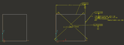

What we have is something like this, yes, this is a meaningless model generated just for show here:
The right side view is a NEW projected view from the left one all in a drawing...
What we is for that right view to come in WITHOUT any of the annotations shown.   (And yes, all those are annotations I created for this example...)
please prepare Creo test data, pack them into zip file and upload this zip file.
