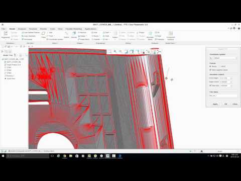

Hello all,
I have used SolidWorks and AutoCAD extensively prior to me being introduce to Creo. I am working with some existing files and my goal currently is to take the models from them, export as STLs so that I can 3D print them.
Here are a few dilemmas I have run into which I cannot solve with a simple google search and would appreciate the experience users to provide some insight.
First when I open the .drw files which have been previously made some or most of the parts are covered by yellow dimensional writing. I cannot hide this for the life of me and this impedes my view of the object I am attempting to work with. How can I hide these measurements and/or labels?
Second in the files I am using I only see "sheets" where can I extract just the 3D model itself so I can see it and work with it to modify in order to make it easier for 3D printing? Any insight would be very much appreciated!

It all depends on how the drawings you opened were created.
If the norm was followed, similar to Solidworks, the master model is "added" to the drawing.
From there, viewports are created to see the model in a certain way.
This should all be familiar to you.
On the left side of the drawing there is a drawing tree and a model tree.
Highlight the model in the model tree and use the right mouse button...
Select "Open".
Now you should see the model that is included in the drawing.
Do note that more than one model can be pulled into the drawing.
You can select different models form the model tree also.

If you are looking in the .drw, this is the "sheet" or drawing file. On the left side will be the model tree. You can right click on this to open the part (.prt) or assembly (.asm). From this you can then make .stl files for 3D printing. See if this also solves your other problem.

First statement : my goal currently is to take the models from them, export as STLs
You don't need to see the model to do that. You don't need a drawing to do that. Your stated goal has nothing to do with your question.
That's veering.
If you still have a problem to solve, please clarify. My previous thousands of posts should indicate that I am very willing to help, even experienced SolidWorks and AutoCAD users.
You used SolidWorks extensively (which was based on Pro/Engineer and is still basically the same) so you know to look to see a model tree on the side of the screen when a drawing is open. Select a model and then right-click to select Open to get the model to open. Then File/SaveAs. See examples below.
