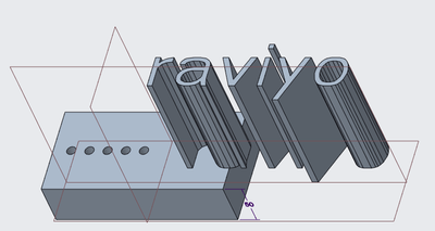

Hi there... I have a logo designed which I need to extrude onto the surface of a part.  I have copied the font into the Creo 11.0.0.0\Common Files\text\fonts folder, and the font shows up in the Font list Sketching > Text dialogue box.  I can write out the logo onto the surface, but it doesn't seem extrude.
I cannot spot any node gaps either.
The font is a really common Windows font: Berlin Sans FB.  Is anyone able to see if you can extrude any words using this font?  Unfortunately, this site doesn't allow me to attach a copy of the font but it should be in your Windows folder if you use.
I'm really puzzled

somethiing about a specifc letter maybe.
EDIT: The r doesn't work, all the other letters in your text  aviyo work
  • I downloaded berlin-sans-fb.zip from https://font.download/font/berlin-sans-fb
  • I unzipped berlin-sans-fb.zip and copied BRLNSR.TTF to E:\PTC\Creo11_020\Creo 11.0.2.0\Common Files\text\fonts directory
  • I started Creo 11.0.2.0 and created extrude successfully
Edit: Font I used looks different from your font. Where did you get your font?

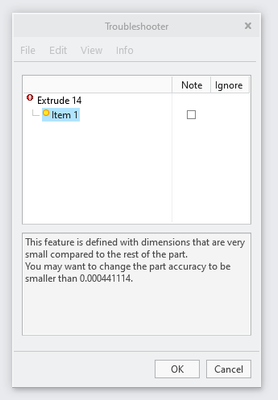

So it turns out that I can do that myself but that's only when the text is pretty large.  When I shrink so text has a height of 6mm, I get the following warning:
I have changed the model accuracy to 0.0001 and the extrude works; anything larger than this and the extrude fails.
But what's the downside of lowering the accuracy to this bottom limit? File size? Speed of regen?... other?

If you are using start parts that predate Creo 7 then you may have the accuracy of the part set to relative rather than absolute. Prior to changing the accuracy in your model, what was the accuracy setting in the part (relative or absolute)?  If the part is using relative accuracy, then that is likely the cause of the issue.
Involute Development, LLC
Consulting Engineers
I'm using 11.0 at the moment, but I cannot recall which version I used to create the parts in the first instance.  Is there a way to check?
And I have checked the accuracy of a handful of the other parts and they are all 'Relative' 0.0012
What's the actual impact or complications I can expect?
Of the 20ish parts in total, there are only 2 parts that I have had to change the accuracy on in order for the logo to be extruded.  If there's a better way of adding the the logo, then that would be great.  Is there a way of adding the logo to a sketch so that it doesn't behave as a series of editable curves (i.e. it was a pdf outline) that can be extruded?
tbraxton
(To:rjethwa)
This relative accuracy is almost certainly the cause of your issues. If you have parts with relative accuracy, then the start parts almost certainly predate Creo 7. In Creo 7 + PTC has only used absolute accuracy. You should immediately update your start parts and use absolute accuracy for all of them. Absolute accuracy should always be used and not relative accuracy.
Relative accuracy is dimensionless and changes with the model bounds, absolute accuracy has units of length and is fixed unless changed by the user.

As I had suspected based on the error message for your regeneration error when you attempted to use 6 mm text height you have a part using relative accuracy. If you use absolute accuracy (of a magnitude to avoid the tiny edge) this error is not present. The extrusion of the text is creating a tiny edge that when using the default relative accuracy causes the regen failure.
As I explained previously do not ever use relative accuracy unless you have an explicit reason to do so, it only invites problems. PTC uses absolute accuracy by default since Creo7.
I am not discounting an issue with the font file but the regen error is due to an edge that is too small to resolve when using relative accuracy at the default value.

I investigated the shape of letter "r" and realized that its shape is problematic. Please replay attached font_problematic_locations.mp4 video.
  • 1st location shows bug in shape definition
  • 2nd and 3rd  locations show short elements
Note: Your model is saved in educational version therefore I cannot open it.
I agree with tbraxton and his suggestion to set absolute accuracy.
I do not have any other suggestions ...
