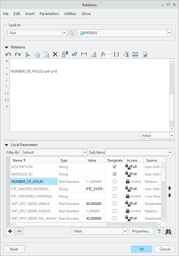

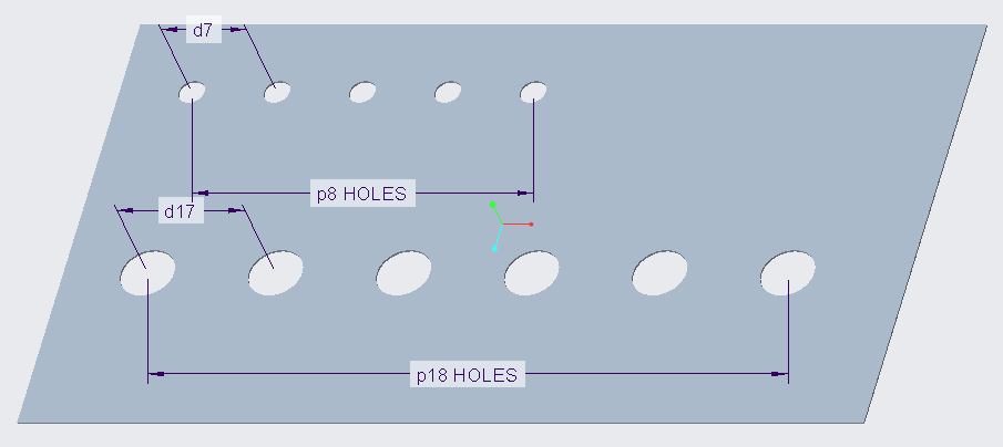

every pattern contains "dimension" representing number of instances.
Therefore you can create relation which counts hole quantity,

For this I'll have to Manually feed this info into Relations and that's the current practice I'm following.
But I'm looking for a way of Automatic Hole Feature Recognition into Parameters / Relations.
