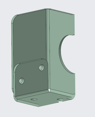

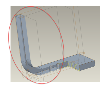

As far as I can tell, this is 100% repeatable, though I haven't been able to test on many parts. The setup for this is to take a sheetmetal part, create an extrude, then create an offset section using a reference plane as the basis of the sketch. Below is a part I can produce the problem on:
NC_10083041_4-1661350527759.png Part looks okay while in the Edit Definition screen of the section, with a gray color on the intersected faces.
Once I create an offset section of the part it looks like this:
Note the visibility of the inner surfaces, as the end which is cut by the section now isn't capped. (I have checked Capped_clip config setting, which is set to YES)
When clicking the 'show hatching' button, the display does not change.
It seems like Creo thinks the part isn't a valid cap as a result of the section.

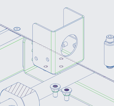

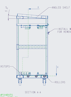

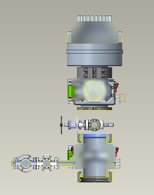

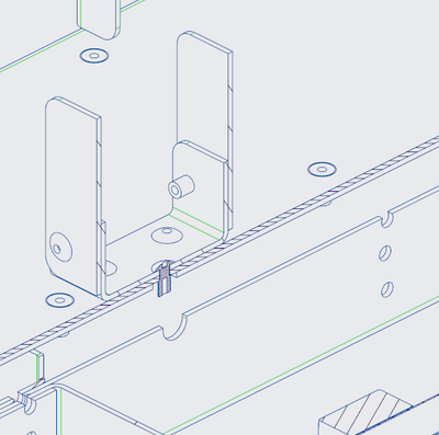

While I could use a planar section to solve the above pictured problem, and end up with a properly sectioned part, the issue I was originally facing was in the assembly in which I am using these parts, specifically the drawing:
This is very peculiar, and another reason I am led to believe this may be a bug rather than a feature/option I have missed.

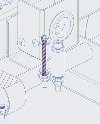

The part is shown in full, not in section; but stranger is that section markings from objects behind are being shown through the part, as if the part SHOULD be sectioned, but isn't for some reason.
Unfortunately I need to use an offset section in this case to show specific parts of the full assembly, so cannot simply switch to a planar section, which would be the easy option.
This seems to be the only component in the 1000+ parts assembly which is experiencing this problem, but I don't know what makes this component special. I have checked there are no interferences with the part, the part is fully constrained, and was placed as part of a pattern (using the reference placement option) but the other components in the pattern are all hidden correctly as a result of the section. The difference with the pattern is that this instance is intersected by the section, rather than being fully consumed; but the base upon which this component sits is perfectly fine, and it is also intersected by the plane of the offset section. If I move the plane which the section is set on, the same error is occurring with the other identical components in the pattern, so it seems to be something to do with this part specifically, but as far as I can tell not due to the fact it's part of a pattern, as other patterned objects are problem free.

Quick edit just after posting this I tried to move the reference plane the problem part wasn't intersected, and discovered the same bug in a solid-body part, so this is not sheet-metal exclusive!
There is even a total difference between the model and the drawing views, with one completely omitting the white roller component, and the other being shown as complete and un-sectioned, despite both being intersected by the same plane and therefore the same offset section operation. Something strange is definitely afoot!

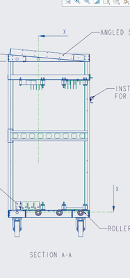

I have noticed an error message which is sending continually whenever the Creo window is active and I hover my mouse over the drawing view. I will investigate this further when I get back next week, but potentially this is unrelated to the section display problem, as when I noticed this error appearing it came with a host of other display issues in the drawing view.

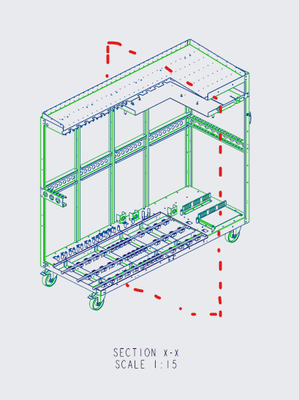

I also thought it would be important to include the shape of the section, in case I am using it in an unsupported way (though even the simpler tests I did on the single component in the model space had the same issues). The reason I cannot use a planar section is that I would like to show different depths of the assembly across it's height, as there is some shelving nearer the top which requires more of the model visible to read clearly, while I also want to cut away more of the base to reveal the structure underneath, all while giving the context of the back and side of the assembly. If this is the cause of the issue and simply an unintended use-case I could try and find an alternative way to display the information, however the fact the iso view is so close to accurate makes me think this isn't meant to be an unsupported use of the section tool.

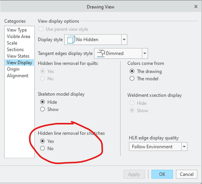

One addendum I have to make:
The drawing view option "Hidden line removal for xhatches" does effectively hide the line which are displaying above/through the erroneous part, but the part itself if still displayed incorrectly, not properly sectioned.

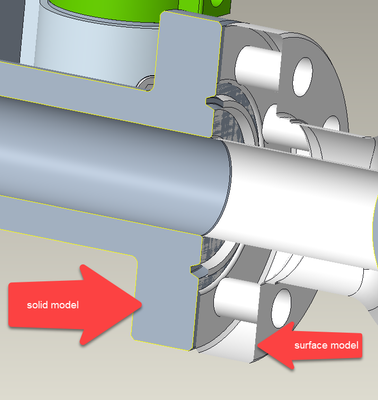

Offset x-section and surface models don't play well together, so if you have surface models, you may never get it to works like you want. On a planar section, you can "include quilts" which will do a good job of cutting the surface model correctly for a drawing, but on Offset section, there is no option for including quilts, so they will not properly section in a drawing.

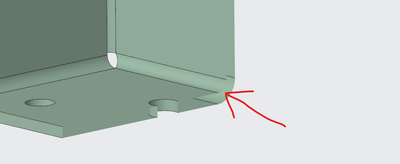

Your error looks like an older error I have seen "x-section aborted in view X" and wouldn't show up at all. I could usually fix that by moving the section cut plane just a little bit (if acceptable, sometimes you can't due to dimensions or visibility.
(sorry for the blur in some images, some geometry is standard, some is propietary)

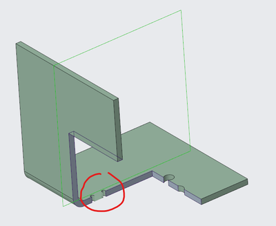

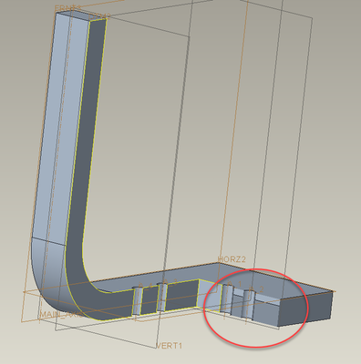

I believe I have gotten very close now to the exact cause of the issue: This issue is arising when a part is sectioned through a pair of extrusion cuts, and the orientation of the section is limited to one direction.
The below screenshot is what led me to conclude the real culprit here. The part below is the very same one used in the bulk of my post above. The altered cross-section set-up is not creating any issues with this bracket. In-fact, the section runs directly through one of the part's through-holes without issue. This proves the underlying data of the PART is not to blame, but how the section interacts with the model's geometry.
The difference with this particular configuration of the section, is that this particular component does not lie on the original plane of the section, and these capped sections are a result of the x-sections EXTRUSION rather than it's ORIGIN.
I will explain this in detail below.

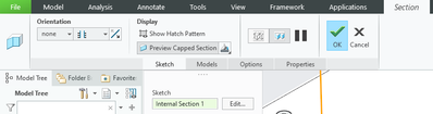

This screenshot shows the setup of the offset section which allows me to create the effect of cutting a chunk out of the assembly (as if dragging out a cube which has been constrained to one corner of the model), which is limited in every planar direction (to maintain geometry on the left, back, and bottom of the assembly to provide context):
The crude dotted red line shows the plane on which the section is based.
Combining the position of this plane and the orientation controls:
I control the 'extrusion' of the section, and in this case, limit the section's depth by selecting the 'none' option.
Further testing

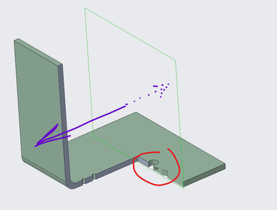

Note in the two images below of a test file, the orientation of the planes upon which the offset sections are based, and where the problem faces lie (the purple arrow illustrates the behavior of the section; based on the shown plane, one side extends and removes a portion of geometry, but the other direction with the dotted arrow is where the orientation controls are preventing the section 'extruding'). The sections are set up in the same way as my original assembly, with the orientation option set to only allow one direction of the section from the origin plane. When the plane creates a new 'surface' which sits between two holes the surface is un-capped, however the exact same holes have no problems displaying when the alternate section is shown, which uses a perpendicular plane to the first. In the cases where the 'extrusion' of the section creates a surface between two holes (in the picture with the purple arrow, the holes on the left by the flange are the result of the section's extrusion) the program has no problem generating the caps.
