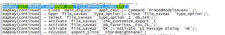

If I am undestanding your question, you want to split one mapkey into multiple mapkeys.  This can be done by modifying the config.pro file.Capture.JPG
Locate the mapkey in the text.  Copy the first line of the mapkey and paste where you want the split.  Rename the mapkey (highlighted text).  Save file.  Changes will take effect after restarting CREO or importing confg file in configuration editor.
You can also copy the entire mapkey, rename, and divide to keep the original.
