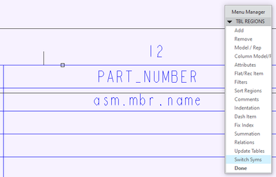

  1. Select “Repeat Region” from “Table” tab
  2. Select “Switch Syms” then “Done.”

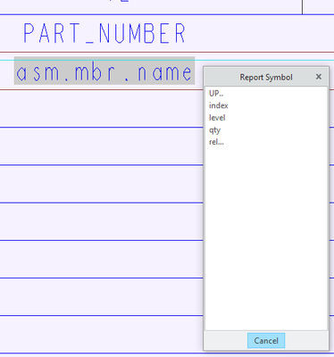

    1. If first item cell of column to be changed starts with “rpt.rel” go to 3.
    2. Double click on first item cell
    3. Select rpt… then rel… then User Defined.
      1. Type in Relation name:

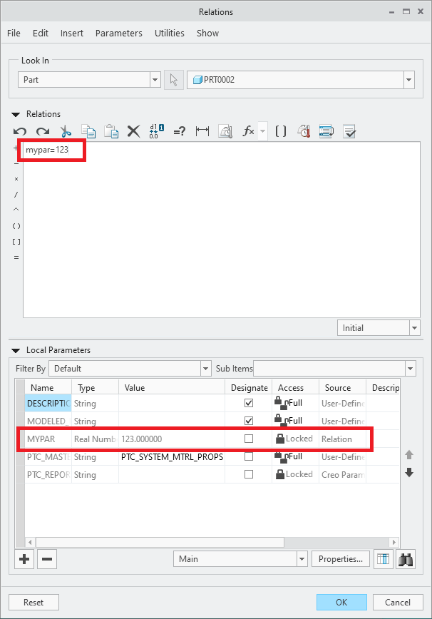

So as source it says "relation":
Unfortunately my Creo Parametric 9.0 Student Edition is in German. Sorry for that.
I do know the relation actually, it is linked to the file name. So whenever I update the filename this parameter updates itself too.
The question is can I remove this relation so that afterwards I can freely edit this parameter?
Greetings
Spedex
StephenW
(To:Spedex)
Yes, if you delete (or comment out) the relation, it will "unlock" the parameter.
You can add /* to the front of your relation to comment it out to test.

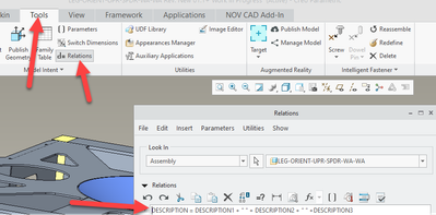

StephenW
(To:Spedex)
@Spedex
Relations are in a different window. Go to relations (TOOLS - RELATIONS)

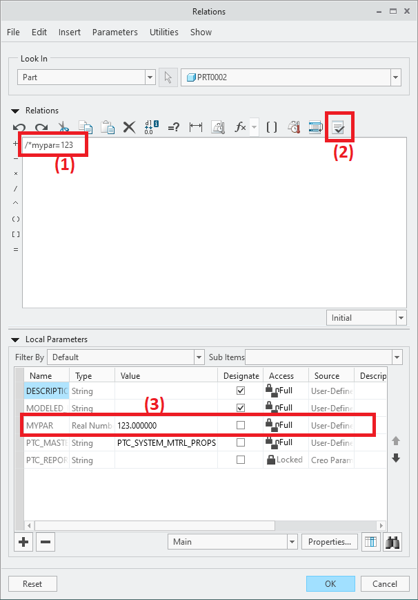

MartinHanak
(To:Spedex)
before
after
Martin Hanák

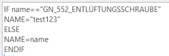

Ok so if i use the following code it still does not work:
IF NAME=="GN_552_ENTLÜFTUNGSSCHRAUBE"
NAME="test123"
ELSE
NAME=NAME
ENDIF
It leads to all cells being empty.

kdirth
(To:Spedex)
The idea is to create a new parameter name in the table (step 2).  Then in the relations, make the problematic text equal what you want and the rest equal to the original parameter (step 6).
Change "NAME" to the original parameter name (SACK_NORM).

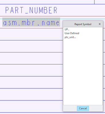

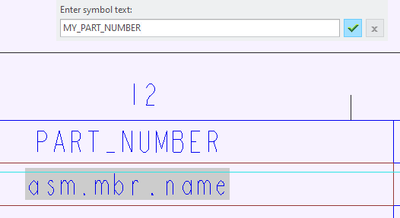

If I want to change PART_NUMBER for a part, I would use Switch Syms and double click on asm.mbr.name
I would then select rpt... then rel... then User Defined and enter a new name such as (MY_PART_NUMBER.
I now have a new parameter in the table:

MartinHanak
(To:Spedex)
NAME="test123"
ELSE
NAME=NAME
ENDIF
If I use this code:
NAME="test123"
ELSE
NAME="NAME"
ENDIF
It leads to all cells (also the cell that i want to change) having written NAME inside of them.
Does sombody know what is still wrong with my code?
UPDATE: Was able to fix the problem that I have though with the other method (deleting the relation)!
from my point of view the following relation code does not make any sense.
NAME="test123"
ELSE
NAME=NAME
ENDIF
Please provide more information:
1.] where do you want to use relations ... in part -OR- in repeat region in drawing ?
2.] please describe the purpose of relation in words ... do not write another code
My example of part relations:
Imagine that I want to define parameter MYNAME in every part model.
If model name = "GN_552_ENTLÜFTUNGSSCHRAUBE" then I want to put "test123" value into parameter MYNAME
If model name <> "GN_552_ENTLÜFTUNGSSCHRAUBE" then I want to put model name into parameter MYNAME
Relation related to my example:
MYNAME=rel_model_name
if rel_model_name == "GN_552_ENTLÜFTUNGSSCHRAUBE"
    MYNAME="test123"
endif
Martin Hanák
