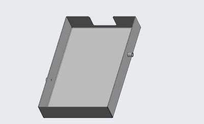

When I create drawings sometimes the values of the parameters in the head of the drawing don't seem to make any sense. For example I created a simple assembly containing a sheet of metal and two pipes:
Sheet 1:
The weight is shown as 3.675kg ( Parameter &PRO_MP_MASS:0 ). The active model is the assembly.
Then I created a new sheet in the drawing with another view of the assembly. The parameter changes to &PRO_MP_MASS:1. And the weight shown is 3,757kg, although its the same part. That doesn't make sense.

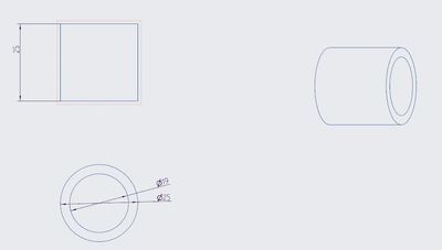

Then I created another sheet (always using our drawing-template) and made the pipe the active model. The parameter is still "&PRO_MP_MASS:1" and the weight shown is 3.757kg. Of course the weight of the pipe must me much lower than the weight of the whole assembly.
Sheet 3:
I don't get how to propperly create drawings. Some parameters change on different sheets (for example parameter "&project" (name of the project), which should always stay the same, I think. Also other parameters like the material_name change on different pages. Sometimes it doesn't show any material. Sometimes the weight doesn't make any sense. How can it display the real weight ?

We (and probably most people) do a separate drawing for the assembly and each component. You could do just one drawing and have notes to identify the part number or other information about each component that you put with its view(s). This might be a fine solution for a simple welded assembly like what you're showing.
I do a lot of drawings, most of them in fact, that have multiple models in the drawing. When you create a new sheet, any parameter values used in the format for that sheet will be pulled from the currently active model. That could be the assembly, one of the components, etc. If I make a mistake and create a sheet with the wrong model active, I could either fix all the parameters by changing the session id for them (the :XX part at the end of the parameter), or delete the sheet, change my active model, and create a new sheet again. The second one seems faster.
StephenW
(To:MaikTheBike)
I agree with Ken, if you want the parameters from a specific part or assembly on the new sheet, make sure your active model is the one you want to drive the parameters on that sheet.
If you are getting different mass for the same model, there is some other different problem happening. I would first regen the model and then each drawing sheet to make sure everything is up to date. Other than that, I don't think I can troubleshoot the problem without the model.

Thanks for your replies.
I followed your tips and now it seems to work. The weight shown in the drawing equals the weigt of the model.
