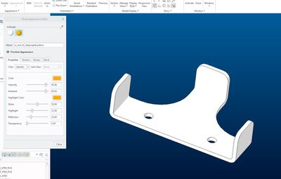

Here, thy this..
it is white, yet I've tried to change it.. you can see in the 'edit appearance, that the color shows, and seems to be selected, yet the white overrides this..

as an update to all who have helped me:
It seems we might have something in our template that is forcing this colour.  When I "remove all" appearances, it reverts back to a base colour (not eh white I see).
So I am assuming we have made / changed some setting to force it to be this colour..  regardless..
