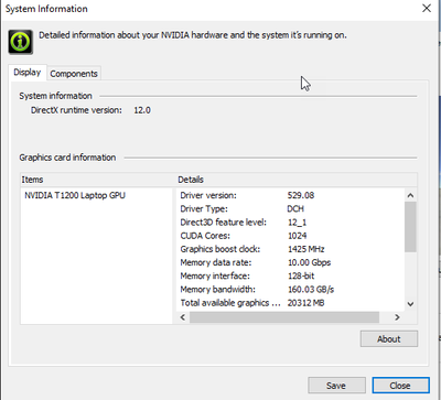

What graphics card is in the laptops? Nvidia GeForce cards are not supported, which are usually used in laptops. They may work, but you will see issues with large assemblies and number of open windows.
chshasa112-AmethystAuthor
August 25, 2023
we have the following ones:
August 25, 2023
both cards are supported. Eg: for Creo 10.0 supported drivers for specific HP computers are mentioned in https://support.ptc.com/WCMS/files/176242/en/hp_creo10.pdf document.
