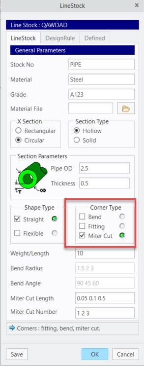

If in a Line Stock options I set Corner Type = Miter Cut

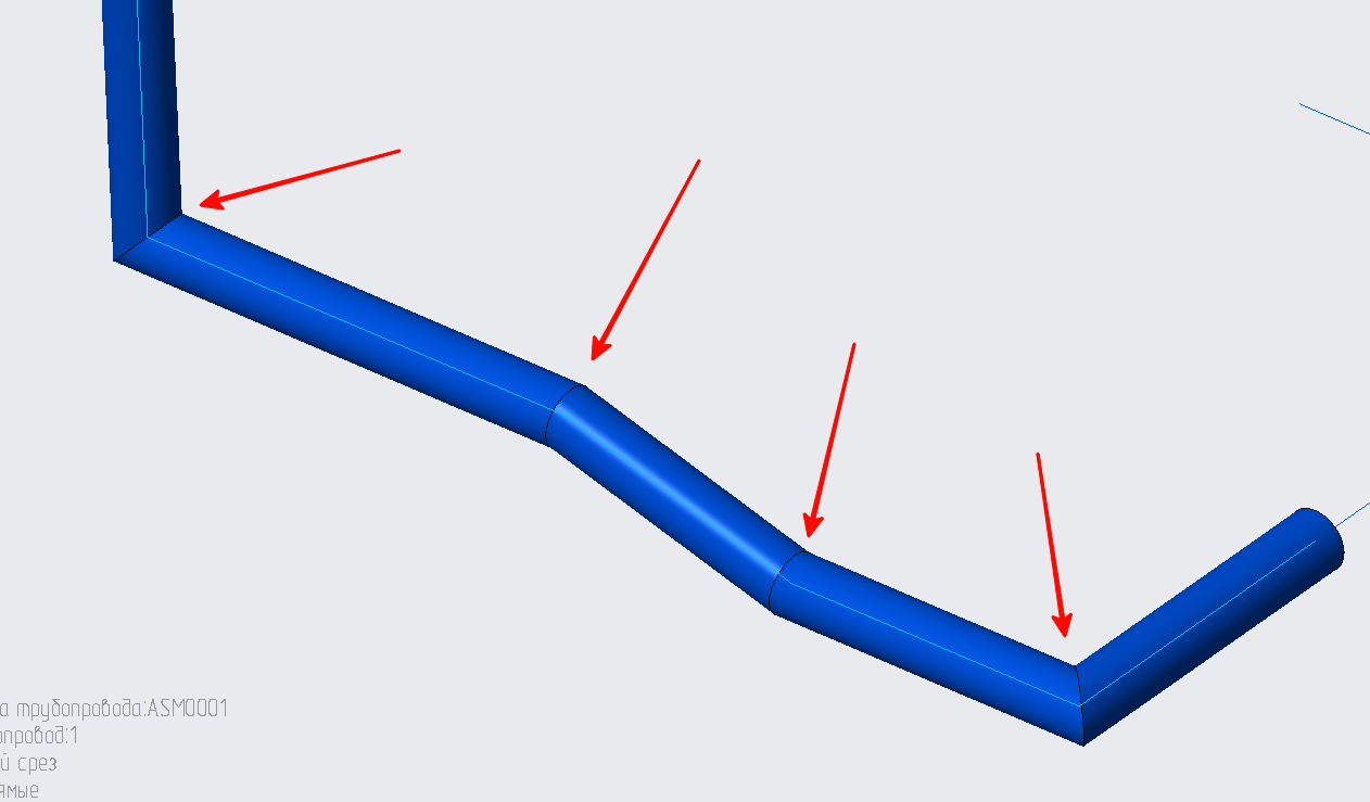

than Creo connect pipes in corners using angled cuts at pipe's ends.

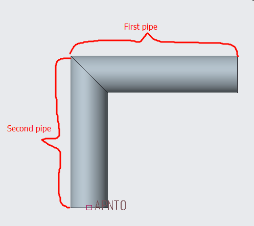

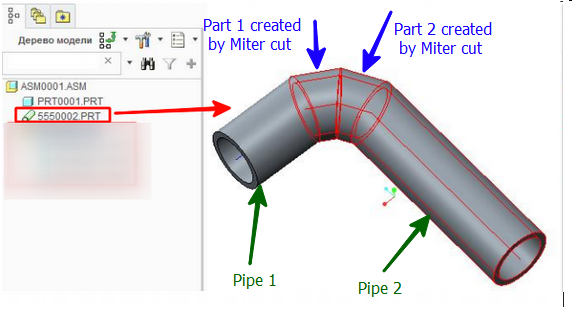

But this will be ONE solid part for pipe. I don't understand how to produce a drawings for segments of this pipe? How to create BOM? Each segment, I believe, must be as separate solid part in BOM.
Some think like this:
What do you think? How do you manage a pipes like this?
