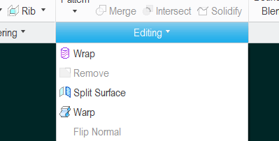

That's just how the math works in Creo.  Those separate face are all part of the same surface...
You can try using the Split Surface tool:

Using the split tool that regularly would probably lead me to check myself into an asylum. We had a sales rep out here tell us that we could change that with a setting in the config.pro file. But I believe you're correct, unless there are other users who know different.

Creo often will consider a surface that has been split as a single entity.  If it was created by a single sketch entity, it'll be considered a single surface.  If it was once whole and a later feature divided it, it's still considered a single surface.
I wasn't aware of the split surface feature, that's a good technique.  In the remove feature and other similar features, you can also often find the option to "exclude contours" under the options tab.  So you'd select the surface you want to remove, select the remove feature, go to the options tab, click in the "exclude contours" box and pick the boundary of the area or areas that you don't want to remove.
