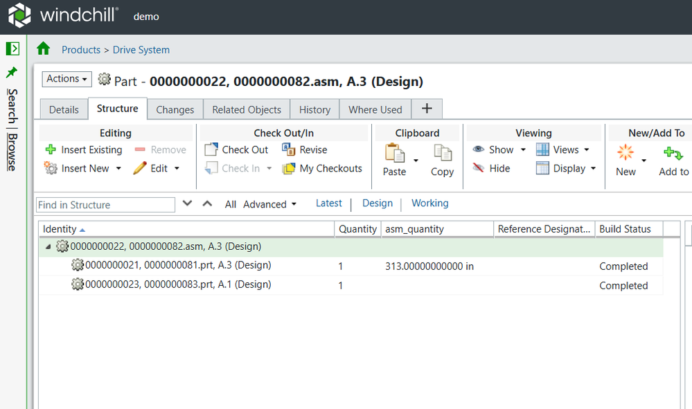

Yashraj_R
(To:N-Pyn)
Or you could try something like-
add an assembly driven attribute asm_qunitity
looks something like-
by-
Not sure how ERP will handle it though, that part needs to be checked
Also note- I created the attribute as "Real number with units" to have both mentioned in the same box
could be helpful
N-Pyn
(To:Yashraj_R)
Hmm, using component parameters could possibly work. I could define the stock material and the length as component parameters in the assembly level and then use some magic in the PLM-ERP integration platform to create the BOM row with that stock material and length in ERP under that component item.
I just had some talks with our production planners and procurement and they want to have the items in our ERP in the format that I have in the screenshot of the starting post. But CAD designers want to have just the cut part as a .prt in the CAD model, so bulk items are out of the question because they would require us to create the cut parts as assemblies. So using component parameters could maybe be used to have the cut parts as just .prts in the CAD and Windchill, but then use the integration platform to insert the stock material and quantity afterwards.
But I think our integration developers will not like this idea because it would introduce more complexity to the integration logic. And also it might be a bit complicated process to create those component parameters for every cut-to-length part in an assembly. At least I cannot quickly think of any way to utilize templates or automation for that task.
I'll have to test this idea a bit and see if I can find an user friendly way to do it in CAD.

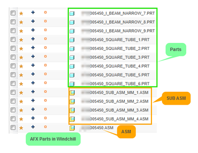

Srinivasan-Iyer
(To:N-Pyn)
Use AFX for such Stock items. Comes with tubes, Extruded Sections, Angles, Channels etc.
Will give you the cut length and the Total Length used of each section.
Bulk Item is typically used for Paint, Oil etc which are not modelled but need to exist in a BOM.
Regards
Srinivasan Iyer
How do you handle them in Windchill? Doesn't AFX create then a new item for each piece of a pipe or extruded profile?
And if I remember correctly, AFX doesn't even use the autogenerated number coming from Windchill. How do you handle numbering of those pieces?
BenLoosli
(To:N-Pyn)
AFX dos create individual parts for everything you create. If your designers are just tossing together an assembly, unless they use the Reuse option, you end up with multiple parts with the same length.
AFX uses its own autogenerated numbering system with a base 'project' number and then an incremental numbering for the individual pieces.
Windchill has no problems with AFX generated numbers.
At my last company, we used AFX for structural racks. The designer would assign a base number and then add all of the parts, They did not use the Reuse button so we had many parts in the system with the same length. For the BOM, they would have to rename 1 component of each shape to our numbering system and then use a repeat region relation to change the quantity to AR for that base number.
Srinivasan-Iyer
(To:N-Pyn)
AFX is used in the context of Assembly.
The Assembly number is Autogenerated (if the configuration is set to Auto-Number in Windchill)
The Assembly number is Prefixed to the Structural Member.
Length of the member comes from the actual length in the assembly.
One can Pattern or Reuse the same member (Section and Length would be identical)
See pic below
Regards
Srinivasan Iyer
What then ends up in the Windchill? A bunch of new unique items every time you create a new assembly with the AFX?
And what kind of manufacturing information is forwarded to the ERP? How are the relevant stock materials associated in the ERP to those new cut-to-length parts?
Srinivasan-Iyer
(To:N-Pyn)
The picture below shows how it looks in Windchill. Please note that the part numbers are Prefixed with the Assembly Number. If the same member is used in multiple locations, the same would appear multiple times with the same part number.
length of the members are read from the assembly Length and is available in the drawing as a table. One may export the table to csv for incorporating in the manufacturing BOM.
You may test the same with respect to your ERP system.
Regards
Srinivasan Iyer

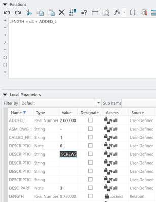

JM_10432119
(To:N-Pyn)
I haven't used windchill in a while. But my two cents are having a part name reflect a part length is a waste of time, name it after it's location or something.
I'm fairly sure that windchill can accept parameters. I don't know if that can be used in quantity the way your system is set up. If not it may be worth handling cut to length parts differently where the quantity is bulk and there's a length parameter.
I associate all pipes to length in notes/ parameters there's different ways to do it. Since you may have curves which complicate automatically accounting for the length there could be an ADDED_L parameter to add to the first straight length like so.
