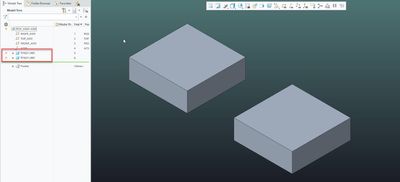

Is it possible to use an Execute statements to drive different parameters to the same model in an assembly?
I want to be able to do something like this where I can pass different values to the parts without having to duplicate the part.
EXECUTE PART TEST1(5)
WIDTH = WIDTH
HEIGHT = HEIGHT
END EXECUTE
EXECUTE PART TEST1(6)
WIDTH = WIDTH + 5
HEIGHT = HEIGHT + 5
END EXECUTE

If you are asking if the execute is capable of creating/adding a new component in an assembly, then I am pretty confident that the answer is no.
If you are asking how the execution is managed in assembly mode, then this may be helpful.
Hierarchy of Assembly Execution
Assemblies can execute subassemblies, which in turn can execute other subassemblies. The parts that compose a subassembly are not executed by the main assembly but are instead executed by the subassembly. Only the next level down in an assembly is executed by the assembly design.
