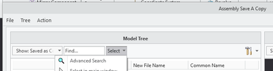

PTC has done something very odd with the "Advanced Search" option inside the "Save A Copy" window.

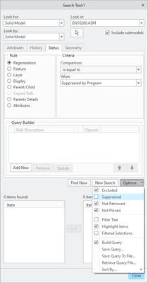

Normally, you can use Ctrl+F to start a new Advanced Search. Under the "Status" tab, you can search for items which are "Suppressed by Program" during Regeneration, but you first have to check the "Suppressed" option under "Options".

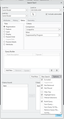

But if you use the "Advanced Search" inside the "Save A Copy" window...
...the option to search for Suppressed components is unchecked and disabled!
I don't know why PTC has disabled this...and I don't know a way to enable that option...
