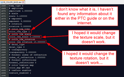

I have some problems with the textures and I ask you for help.
I would like to get a color that loads me a certain texture with "Flat" mapping and XY scale with a value of 4, but the program only saves the assignment to the texture file in the color but not the mapping or the scale values ...
This is the result that the program offers me by recalling the color I created:
I would like to obtain this result by pressing the color I created:
I made a few attempts:
1 - I tried to create a macro that sets the color and then changes its appearance, but in trying to change the appearance the program prompts me to reselect the model and that's something I would like to avoid ....
2- I tried to study the lines contained in the .dmt file. I found some interesting parameters but they don't work ....
Can anyone help me? Thank you.
P.S. Use creo 9.0.0.0
Solved! Go to Solution.
