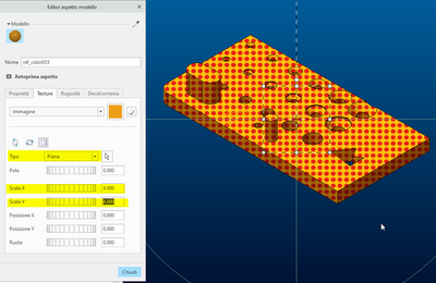

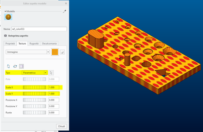

I have some problems with the textures and I ask you for help.
I would like to get a color that loads me a certain texture with "Flat" mapping and XY scale with a value of 4, but the program only saves the assignment to the texture file in the color but not the mapping or the scale values ​​...
This is the result that the program offers me by recalling the color I created:
I would like to obtain this result by pressing the color I created:

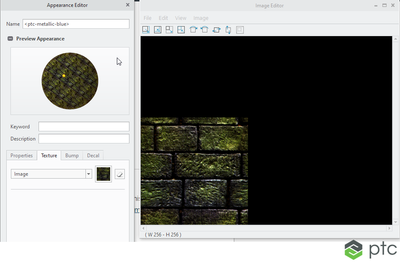

You have defined some texture and you need to have it available for other uses. when searching the Help Center i have found this page: https://support.ptc.com/help/creo/creo_pma/r9.0/usascii/#page/fundamentals/fundamentals/To_Save_Textures.html that tells that the texture can be saved in the model thanks to an option.
To save it separately, basically you need to preview your texture and then RMB the preview itself, it will fire the Image Editor:
Where you can File > Save.
Also i don't recommend to leverage the dmt file rather use the UI.
