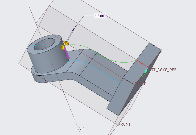

I am trying to create a part from the solidworks model mania series.
The part includes an S shaped rib feature.
The feature fails to generate beyond this very narrow thickness
What am I missing?\
I am using creo parametric educational edition
I have included a link to a YouTube video I uploaded showing the exact process I used to create this feature.

It is possible to build this using a profile rib to match the drawing reference. Do not include the rounds/fillets in the section for the rib. See the video for how to build it. As general rule do not include fillets/rounds in Creo sketches unless absolutely necessary to design intent.

What's the OD of the boss?
52mm OD, 32mm ID
Dale_Rosema
(To:KJ_11561832)
You can't add a 60 mm rib to a 52mm boss. It doesn't know what to do with the extra 8 mm.
Sorry that was my bad. I extended it too far in the example image, but I meant to create a 12mm rib and it still doesn't work.image.png
It appears creo is having trouble connecting it to the boss.  Try extending the line beyond the silhouette edge.

I tried the profile rib in 7.0 and 11.0 with the same results.  I would suggest using an extrude rather than the profile rib, since Creo is not able to follow the curvature of the boss.
