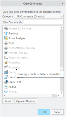

I am using V5.0.2.0 and I can not add the "properties" selection to my RMB.
I am trying to pull up the properties of a dimension, I have gone to the customize tab to add "properties" to the RMB however it is greyed out. There are several other selections that I am having this problem with. Any help would be greatly appreciated

The item is grayed out, may not be what you are looking for. If you hover over the option, a help pop-out will tell you the path to that option:
