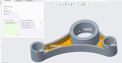

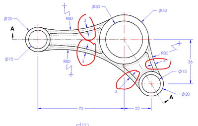

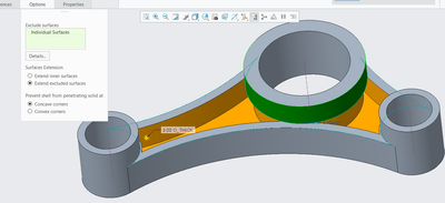

I am trying to recreate this model from solidworks modelmania 2013. (https://blogs.solidworks.com/tech/wp-content/uploads/sites/4/Model-Mania-2013-Phase-1-Drawing.jpg)
I thought about using the shell feature for the offset walls of value '3' circled below.
I believe I would be able to do this by using the shell, exclude surface feature however I was unable to do that; and it does make sense since the surface is not extended down into the other surface.
In the end I decided to use non-default thickness and it worked fine.
I wanted to ask how you would approach this? As always I really appreciate all your help.

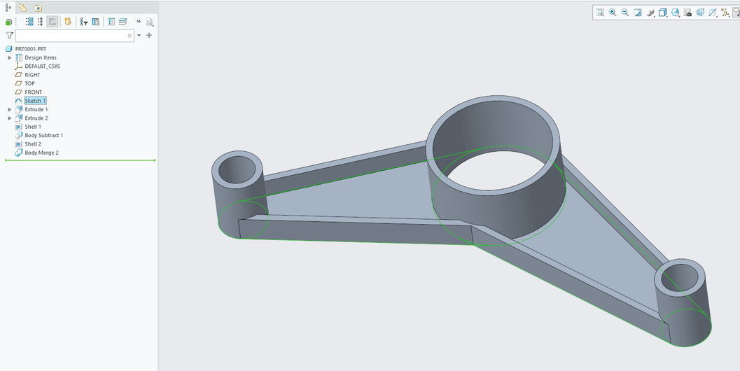

If you're on Creo 7 or later, this sounds like a job for multibody modeling. Make the cylinders and the connecting parts as separate bodies. Here's a quick demo:
- Make a master sketch containing the three circles and the tangent lines.
- Use Sketch Regions to extrude the entire sketch (including the cylinders) to the base thickness.
- Extrude only the three circles, using Sketch Regions, as a separate body.
- Shell the main body.
- Subtract the cylinder body from the main body, while keeping both (so don't remove the cylinder body).
- Shell the cylinder body.
- Merge the two bodies together.
If you don't like using sketch regions (to be honest, I don't), you could do the same thing by just constraining the cylinder extrude to the first extrude sketch. That's probably better, to be honest. Fewer references that risk breaking.

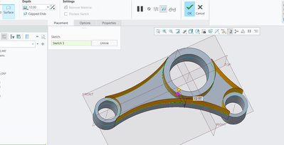

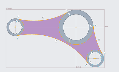

I tried doing that but I can't for some reason any idea what the problem might be?
The sketch.
Extruding as a surface or solid works.
But thicken sketch doesn't work I suspect it due to the corners being too close.

Create the shape in the top view. Then raise the walls around the perimeter. Refer to the video as a guide.

Ah okay I understand now, I was trying to create the thicken sketch after extruding the cylinders and that does not work. Thickening the perimeter and then creating the cylinders works perfectly. So I was messing up the order in which to do it resulting in the error. I definitely prefer your method over mine thanks a lot.

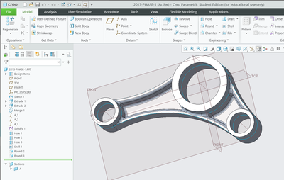

The second phase of this challenge is as following. The main difference being there's is a partial "shell" feature/cavity on both sides that do not extend throughout the faces.
Would there be a possibility to shell still or is the approach as I suspect to remove the material by using extrude or perhaps using tbraxtons method.

I would stick to my previous answer, but each cylinder and each "floor" would need to be created individually.

Looking at your video, the thin extrude would work the way you are creating the cylinders as solid, then extruding holes later. I was extruding cylinder walls that are 2.5 mm thick. When thickening a line by 3 mm that is tangent to the cylinder it thickens 0.5 mm inside the cylinder.
In your video, the thin extrude does not work because the thickining lines clash at the bottom of the large cylinder. Try going around the outer perimeter with your lines and it should work fine.

I just learned that you can extrude sketch regions and what multibody modelling is, this is so good. Thank you very much for the guidance, I never realised the significance of bodies before this.

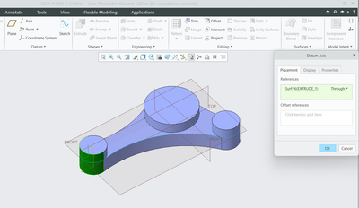

Another question how are you creating the holes in the model because for concentric circles I have been using the outside circles to create axes and then using that axis to create which I feel is quite a tedious method.

Axis are created when a full circle is created. If you have layer rules, they may be automatically added to a layer that is hidden. If I want an axis in the center of an arc, I will add a Point from the datum section of the ribbon, not to be confused with the Construction Point in the sketching section. This will create an axis when the sketch is extruded.

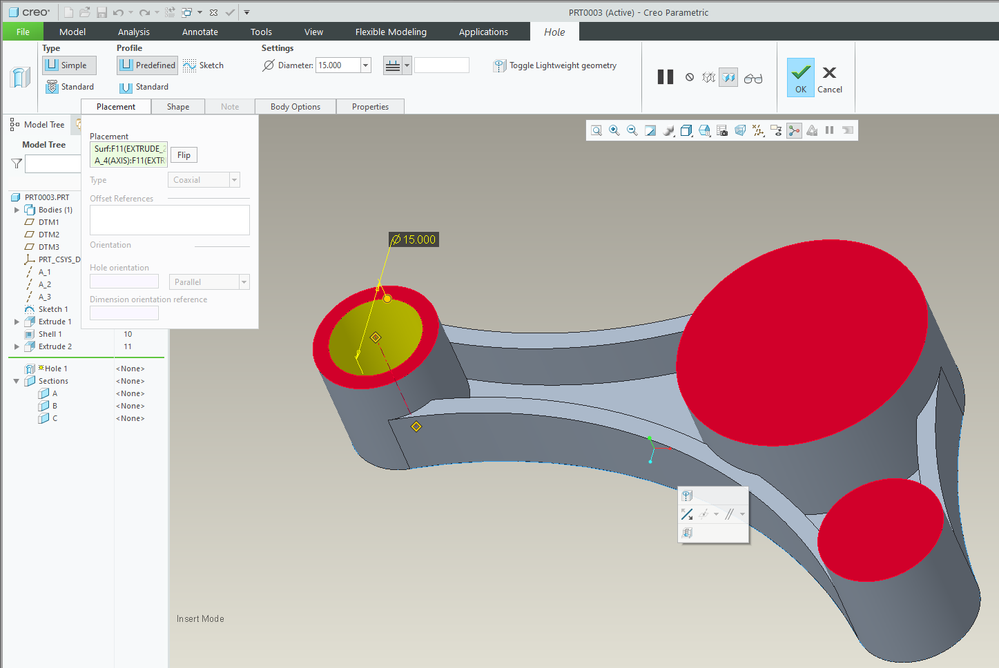

My holes used the axis that exists from extrude 2.
