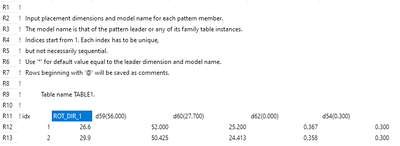

I have a table pattern in creo where an angular dimension is considered in the table which i didn't find in the part. In the pattern table the dimension name is ROT_DIR_1.
Which dimension is this? Please reply if anyone have the answer. Thankyou.

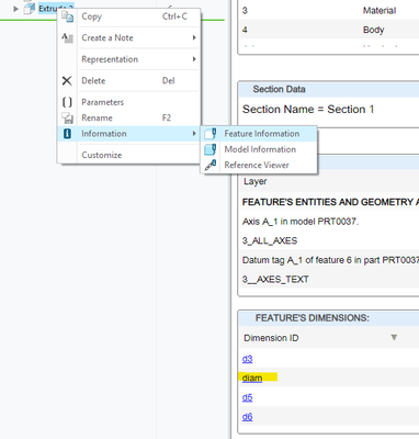

You can view any named dimensions in the info of a feature.
RMB on feature in tree and select Information > Feature Information and scroll down to FEATURE'S DIMENSIONS section.  Hopefully you don't have a lot of features to pick from.

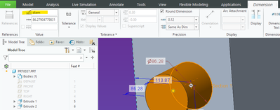

If you use Edit Dimensions on a feature and select a dimension, the name can be found in the Dimension tab.

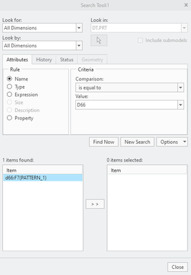

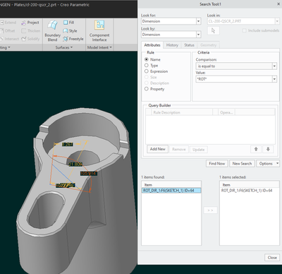

Try searching for this dimension.  Use CTRL+F or click
Then find dimensions, looking by dimensions
If it is found, the relevant feature will be listed in brackets, e.g.:
Satyendra
(To:pausob)
d66 is that dimension, but i am not getting that in the feature.

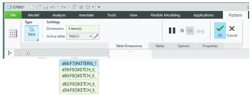

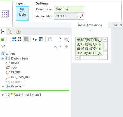

Can  you post a screenshot of the Pattern feature with dimensions and the Table? That could give an insight as to what is happening.
The dimension d66:F7(PATTERN_1) is not there inside the feature. The same dimension is added in the table as ROT_DIR_1.
ROT_DIR_1 = d66
  • you cannot display none of these names ... they are hidden inside pattern feature
  • I do not have any idea how did you created the model, therefore I cannot explain its behavior
  • try to create model once again and note down the exact procedure

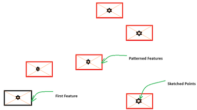

Just a thought....
A table pattern is used for Non-Uniform Pattern. One can achieve the same effect by sketching "Points" and then use the Point as reference to create the feature to be patterned. Use Point Pattern or Geometry pattern to achieve the same result.
Hope I have understood the requirements.
