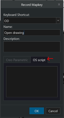

Hello Team,
-Creo 9 with Windchill.
I'm looking to create a mapkey to quickly open a drawing of a room that's already open.
I've done a lot of research and i can never find a working solution. please don't redirect me to an alternative solution.
I know that a part can have several drawings or be included in other drawings. However, in my case, 90% of the parts created have only one drawing, which has exactly the same name as the part, with .drw instead of .prt.
I've created a relationship: DRAWING = PART_ID+ ".DRW".
I now have a parameter with the right value.
Since copy and paste doesn't work in mapkey commands, is there a line of OS script code that you could put in a mapkey to say, open "parametre drawing"?
I work in a company that doesn't allow third-party applications to be installed.
Thank in advance.

How does this mapkeys work?
When I try to create one in Creo, I am limited by the number of characters I can enter in the OS script tab.
This is probably not the right way to do it.
Can you help?
Hi BH,
Yes this is the mapkey, but it is a nested mapkey, so you need also: storetmpfile mapkey, partnameopen mapkey, loadconf mapkey...
If you take only a piece, it will never work.
