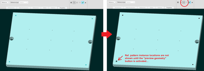

Hi All,
I'm creating a reference pattern of screws in a bolt circle.  I need to skip two holes where I need longer screws.
The dots that allow unselecting instances don't show up when I'm in the pattern creation.
This only happens on certain components of the assembly. I thought it may have to do with the fact the driving pattern is an assembly feature (in a sub assembly), but it works for other sub assemblies with hole patterns.
Any ideas?  It's only 8 holes so I can insert them manually for now but it would be nice to figure this out.

pausob
(To:HBreton)
This is a long shot (since you say that you do see the preview dots sometime), but thought I'd mention this anyway.
On my config.pro, I've disabled the "geometry preview":
So I don't see the dots until I enable it during the pattern definition:
