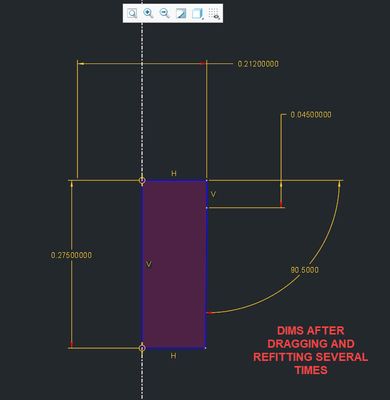

After updating from Creo 4 to Creo 7, we are having problems when redefining sketched hole features.  The dimensions are stretched way out across the screen,  If you drag the dimensions and refit several times, you finally get back to the proper view.  Is there a config setting that I am missing that could solve this problem?

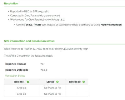

rzukowski
(To:rzukowski)
Thanks for your suggestions.  I tried them but to no avail.  I just found the same issue documented in CS329515.  It looks like a bug in Creo 6 thru 8.  Not sure what the Scale/Rotate tool is supposed to do.  With this and other quirks, I'm thinking that Creo 7 was a downgrade from Creo 4 - just my personal opinion.
