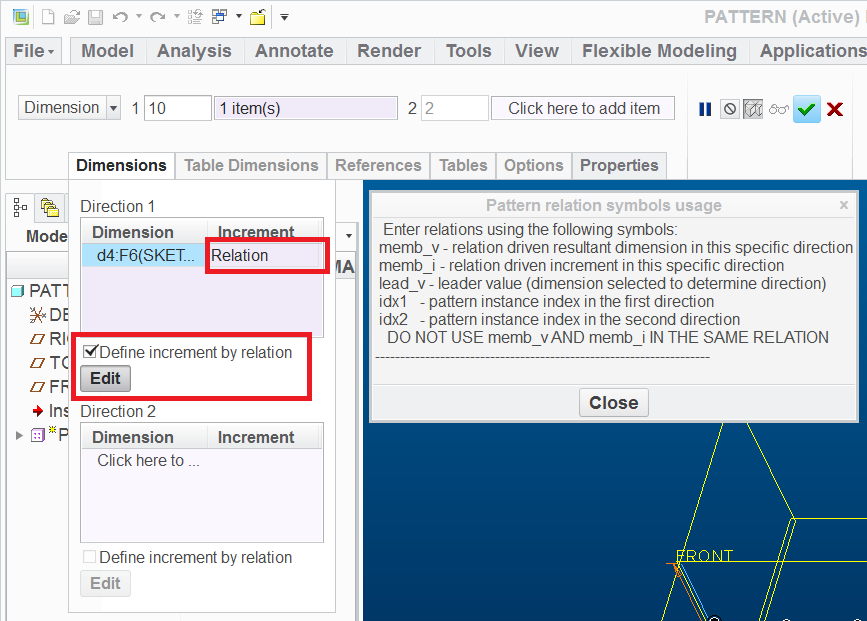

i have been using dimension pattern, where in, i have given the increment value for center to center distance as 4.
i need the distance to keep reducing by 0.1 for every instance , like
c-c for my first instance is 4 , 2nd should be 3.9 , 3rd is 3.8 .. and so on ..
how can i achieve this using relation ...
is there any command like "do while", "for" that can be used in creo ...
Thanks in advance.

One way is to set up an equation for the memb_i value.
memb_i = di - 0.1*idx1

MartinHanak
(To:vdevan)
edit pattern definition and set relations. See following picture taken from CR2.

vdevan
(To:MartinHanak)
Hey Martin,
Thank you for those pics.
I have found out that option to go to relation.
I am not able to successfully create a relation with those variables.
The logic is pretty simple, can do it with a do while command..
but i do not know how to establish a realiton in here (creo)... and am not well aware of the syntax...
can you help me with some examples ...?

Hi ,
Thank for that equation.
That seems to work ..
can you please tell the variable "di" means..
but, i used the following equation and it worked ..
memb_i = lead_v - (0.1*idx1)
Thanks a lot..
Kevin
(To:vdevan)
The variable di is the initial dimension selected to define the pattern increment. In your case lead_v = di = 4 I just specified the dimension in the equation directly instead of using lead_v.
