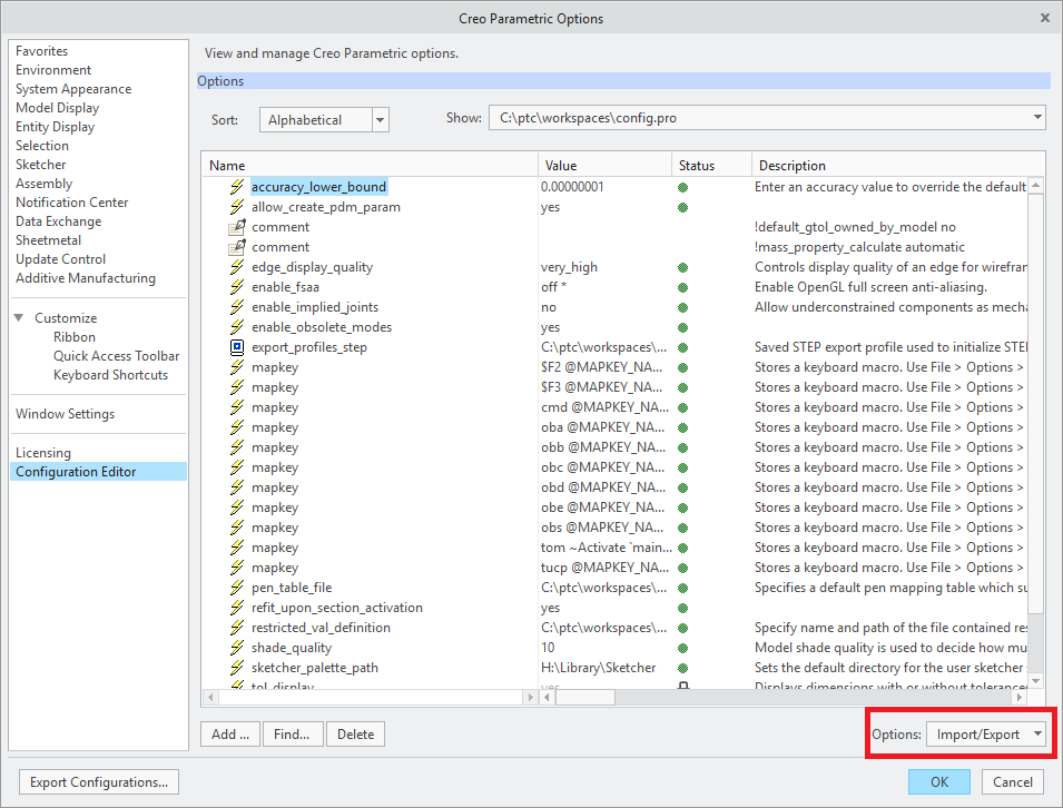

I don't know if the picks are the same in 2, but in Creo Parametric 4.0 it's File, Options, Configuration Editor, Import/Export.

Yes, just re-read (open/import) the config file that contains the mapkey.

Well it's probably right in front of my nose... but I don't see how to do that...

Note that you can create a mapkey to re-import any config.pro that you want.  I have a mapkey that does a couple of different locations so that I can do fast testing of ours.  To create just record the import process, but for a cleaner mapkey make sure to paste the entire path when prompted for the file (navigating and typing will create an unnecessary an nearly un-editable mess in the config.pro)

Is it
OPTIONS...
Configuration Editor...
Import...

Yes.
