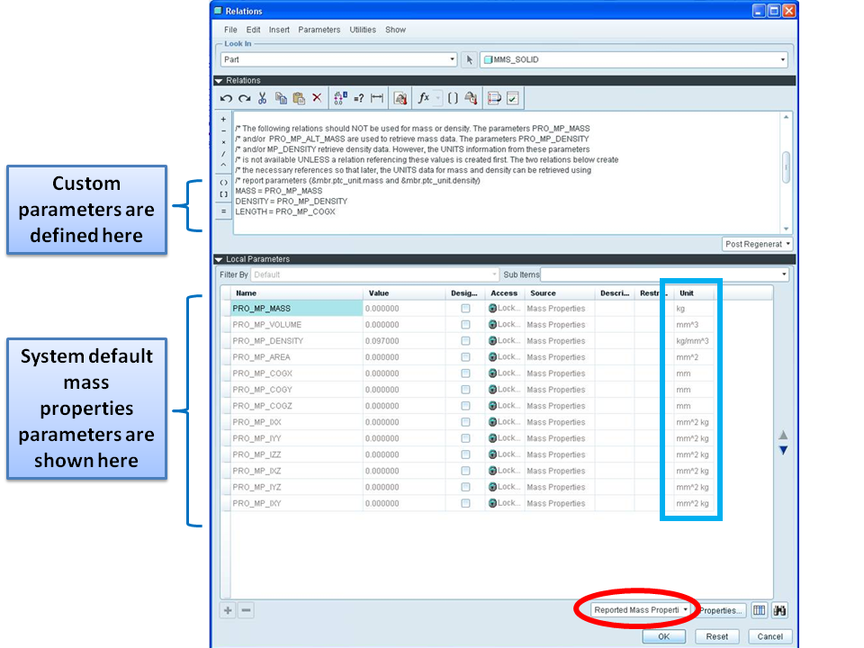

If we wanted the mass or density, we could just look at pro_mp_mass or pro_mp_density. There are about a dozen other parameters like this for every model as shown in the image below. Select "Reported Mass Properties" from the drop-down (circled) to see the standard mass properties values for any model. Notice there's a column labeled UNITS (blue rectangle) but we can't see any of those units in our repeat region. Why? Because these system parameters already existed before we turned on the Units Sensitive option. Click the image below for a larger representation.
Notice in the upper half of the window, you'll see the 3 relations I mentioned earlier.
