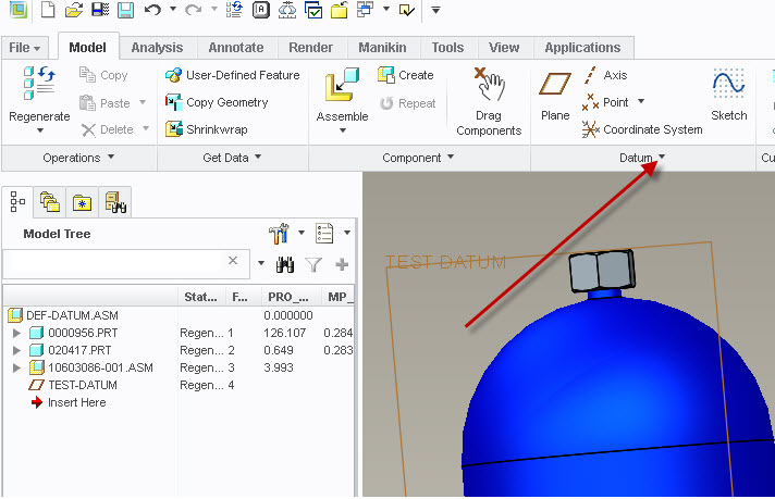

Thought I would clarify with images.
Assembly has no default datums, probably created empty as Martin suggested.
1. Create default coordinate system under the dropdown arrow by Datum in the model tab, select detault coordinate system.
2.Move the default coord system to be the first component. I selected all components in the model tree and drug them below the new coordinate system.
3. Drag the insert here to just below the new coord system.
4. With nothing selected, push the plane creation icon, it will create the 3 default datums
5. rename the default coord system and default planes to your standard.
6. Cancel the insert here

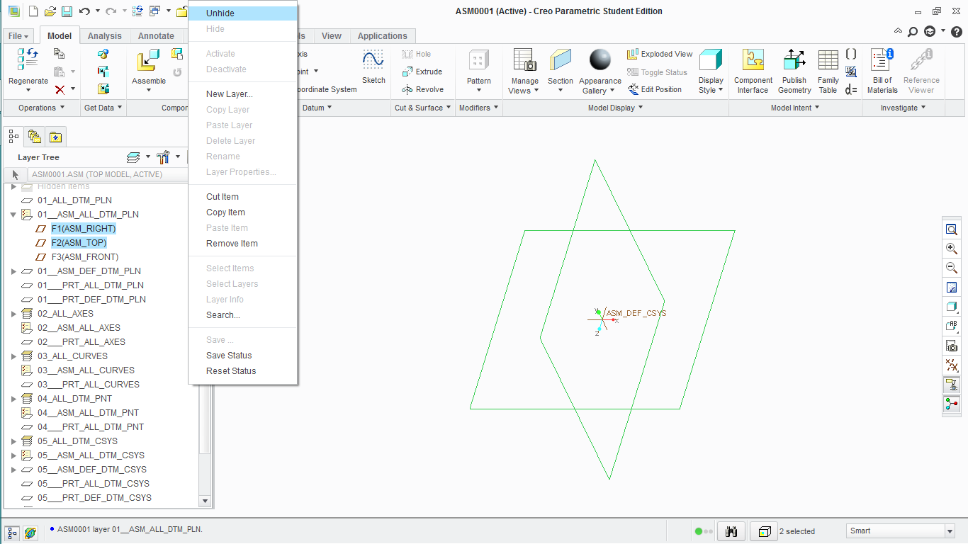

Hallo Ruben,
thanks for your reply. No, I do not need them just in the model tree, but just them to be present.
In fact you can see below that in the layer tree I don't have any mininal sign of the original datum planes, but only of the three planes I have added in the way Stephen suggested. See both above under "01_ASM_ALL_DTM_PLN" (where C0006 is just the bearing), and below under the voice "piani" (that is the Italian of "planes").
bye bye
