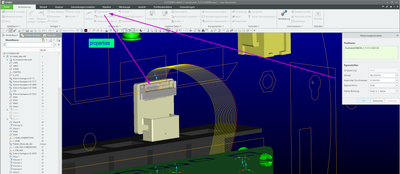

Hello!
I have the problem, to control the twist of ribon. I rotate the coordinate systems without result. How to do it?
Thank you in advance!

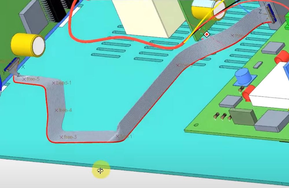

Edit the routing of the cable and include folds and/or bends along the route.
Involute Development, LLC
Consulting Engineers
Easy to say. You see, that the red line goes to other site. Here is not clear how to say, what is left and what is right.
www.pi-engineering.at
tbraxton
(To:PI_6131154)
Manually routed ribbon with folds turns cable 90 deg from proximal to distalManually routed ribbon with folds turns cable 90 deg from proximal to distal

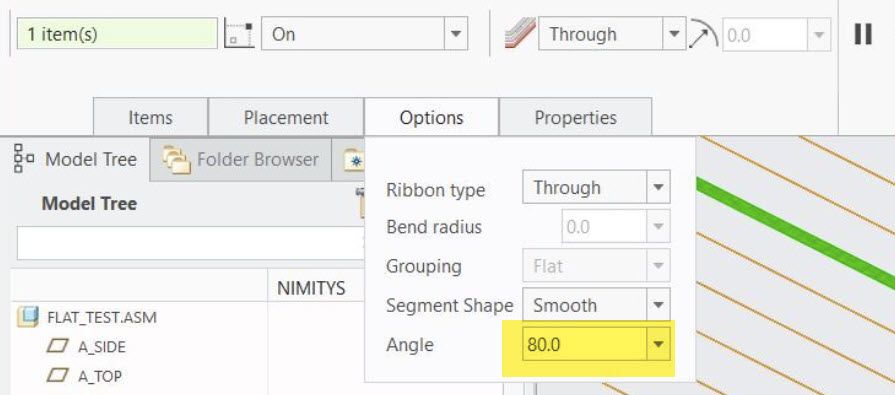

If you want explicit control of the angle of the cable at specific locations along the path then create a network for the cable.
1) Create a network for the cable
2) Route the cable using network
3) Edit the angle parameter at network locations as required to twist the cable. You will find the angle control under the options tab.

 Are you using autoroute and applying the position of the connectors to achieve the 180 degree rotation of pin 1 on the connectors? If so I did not interpret your request accurately. So you are able to autoroute and have the cable rotate through 180 degrees?
I read your request as a desire to control the cable orientation along the routed path. This is the only other way I am aware of other than the fold and bend approach mentioned above to control orientation along the route.
Network location of routed ribbon cable angle control example.
Angle control of cable at network locationAngle control of cable at network location

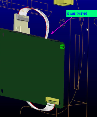

O.. OK. this is one way more as you show.
I wonted just to have the red line on the opposite pin.
Now I have it.
it was as shown
