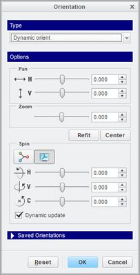

For the 90° orientation, make a mapkey using dynamic orient. Go to the view tab, saved orientations, reorient, then you'll get a pop up orientation box, change the "type" to dynamic orient. Then you and key in orientation angles based on the axis you want to spin around.

You can dynamically orient a view and chose horizontal with a value of 90 degrees.
If this happens often you can capture a mapkey to make this move. Or create a mapkey that selects Top.

Great.

Thank you a lot , that was helpful.
