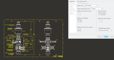

I am creating a drawing using a skeleton of a vehicle that I am mounting components to. Is there set show skeleton display to all views at once or do I have to do it each time I create a view?

You select all the view on one sheet and RMB Properties and you can show change all of them that are selected.
If I was doing this regularly, I would make a mapkey. Preselect the views then run the mapkey
I don't believe that there is a config setting for skeleton model display to set it in the view properties as shown by default or an option to change all views on all sheets in one click.

I have to change the skeleton model display after creating each view by clicking show. Wondering if there was a to change the default to show so I dont have to click this for each view.

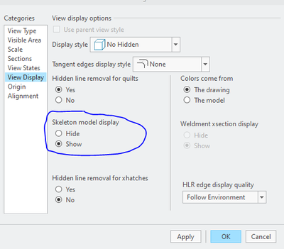

Try this, note step 5:
  1. Open Drawing View Properties
  2. Select View Display
  3. Under Skeleton model display, select Show
  4. Click Apply
  5. Save this status in the assembly through View > Visibility group > save Status

Save status only seems to allow me to save when I hide items but not when I want everything showing:

I just did q quick test in Creo 7, it does not appear to work as documented for saving the status as written in step 5. I read that to imply that this setting will be applied to the active assembly in the drawing when saved but I am assuming some things not explicitly stated.
I do not know why that is not working as documented. It is possible that it is a bug, if you think it is open a call with tech support using this link.

I think that article is incorrect, or at least step 5 applies to layers or shown/hidden items and not the view properties option for skelton model display.
Anything in the view properties dialog boxes should "save" once you apply or ok in the view properties dialog box.
