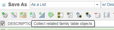

I can not use the Save a copy function because the majority of the parts in the assemblies have flat patterns as a family table instance. Save a copy will not grab family table instances.

Anyway: not sure why you can't do a Save-as-copy in Windchill; it should handle family tables and add instances into the table of new objects:
