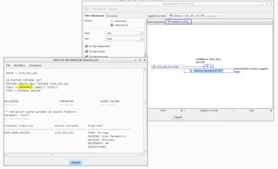

I have encountered a problem on the reference viewer

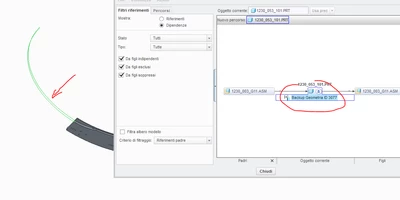

In particular, when I find a dummy reference, or geometry backup, I see the prt and asm it points to, but I don't see the feature. (see image) Only the geometry backup ID xxx calls me.

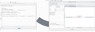

By expanding the popup I see the backup reference graphically.

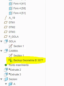

Unfortunately I haven't found an analytical system to locate the geometry backup in the model tree, net of going to info feature, but it seems a bit cumbersome.
I tried the finder, but without success.
The only way is to expand the whole model tree and scroll.
Is there an alternative solution?
