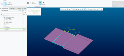

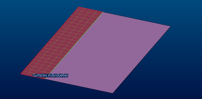

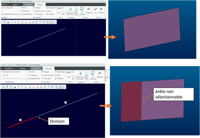

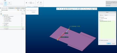

Hello
I want to know if its possible to select fictive line on 2d surface: generated with divised line ?
Config option?
It is only possible by copying a part of the surface
With 3d curve and variable sweep its possible because creo generate a isoparam
Thank you

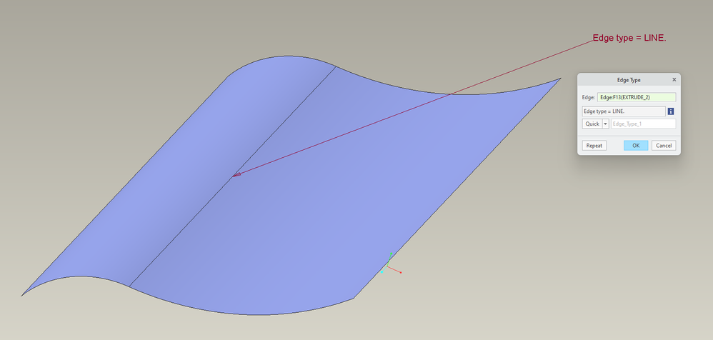

I do not believe this is possible with the geometry you have shown if it is a coplanar quilt.  There is only one surface in the quilt and there is no interior edge in the geometry. There is no line created using when constructing the geometry as you have shown.

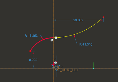

You can select interior edges of G0, and G1 continuity when following the same surface creation paradigm as you have used. Here is an example of a G1 surface connection line edge type generated from a divided sketch of two tangent arcs.

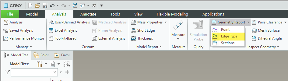

Use the edge type analysis to query "edges"

Thank you and using edge copy it is possible to find this fictive line: with shift command
