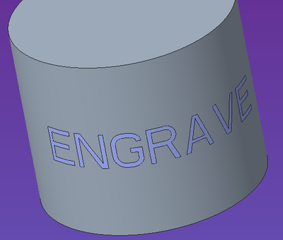

I have encountered an issue that I cannot seem to solve, when working with sheetmetal parts.
The sheetmetal part has different features to be placed 360 degrees around a cylindrical object, for laser engraving purposes. So the thickness of the sheetetal is on paper irrelevant - so ideally so thin it is just visible on the assembly.
The dimensions of the sheetmetal part matches the diameter of the object and so does the features on it - atleast theoretically. The sheetmetal bend is set to 360 degrees and to keep the dimensions on the inside of the bend.
But, when assembling the sheetmetal with the cylindrical object, I get small inaccuracies on the technical drawing of the assembly - the angles between the features do no longer match, which is an issue on the given task.
I have found out that changing the thickness of the sheetmetal impacts the position of the features, even though the part is set to keep the dimensions on the inside of the bend, and I do not know why.
I am working in Creo 7.
Can anyone help me on what I am doing wrong or how to find a solution? Thanks.

In the settings used by the engineers creating the parts (years ago), they had applied a default K-factor on the sheetmetal 'bend' feature - even though the part was not intended to have, bend back, stretching etc..
This was not obvious to me in the first place, since I had not worked with sheetmetal before in Creo.
So after instead inputting a K-factor manually to '0', I could adjust the compensations already made to the part and start using the theoretical values instead.

"I have found out that changing the thickness of the sheetmetal impacts the position of the features, even though the part is set to keep the dimensions on the inside of the bend, and I do not know why."
What observations leads you to this conclusion? Queries of dimensions in part/assembly mode or changes to dimensions seen on a drawing? If drawing dims, how did you create the dimensions in question on the drawing?
More information is needed, post the models and more detail on what is happening when the thickness of the part is modified.

Is the final design intent to show the laser engraving on the surface?  Would using Designate Area accomplish the required result?
Wrap a sketch around the cylinder and designate areas to be engraved.
