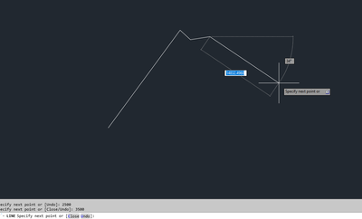

Hmm, I am guessing you mean something like dynamic input mode in AutoCAD:
Yeah, that's not a thing in Creo Sketcher. I guess it would be something nice to have - but I find that most of the time, creating a sketch is a 2 step process: 1) sketching the exaggerated intent shape, and 2) defining the constraints and dimensions to lock-in the design.
I was a little worried that would be the case. I'm most familiar with AutoCAD's little brother, Fusion, in which you can just draw, 10-key, draw, 10-key, draw, 10-key, and crank out sketches super fast.
