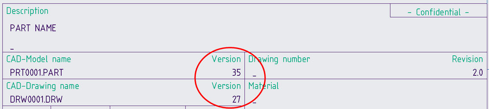

Hello everyone,
I'm trying to find a way to show the file save iteration number in a drawing in Creo (Version 4.0 and higher). It will be used for projects without a PDM system to show the exact save iteration, in addition to a revision parameter.
For example for a drawing of a part named DUMMY.PRT.35 I would like to extract the number 35 either directly in the drawing and show it in a note -or- in the part model by placing it into a parameter I can reference in a drawing note.
I haven't found if this is possible somehow. The rel_model_name and model_name parameters do not seem to provide this functionality?
Any help is appreciated!

    Hello Martin,
    I'm not sure how to explain this in a different way, but this is an example of what it should look like:
    Files on disk:
    Drawing:
    Note that this in only meant for cases in which no PDM system is available (in which case I would use e.g. PTC_WM_VERSION and PTC_WM_VERSION:D ).

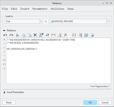

    I think you'd be better off having a parameter in each file that is the "version" or whatever you are calling it, where the person doing the work has to manually change it whenever they are saving their work at a particular "finished" state. Manual = could be forgotten, but not a number that is incremented every time you save a file.
    Maybe another way of hacking this without PDM would be to keep track of the number of times the model has been regenerated:
    (then display &MY_VERSION in the drawing title block)
    There would still be issues that require a manual procedure / check.  For example, when you add a feature, the software does not necessarily regenerate the model.  Another thing is changing layer states would not trigger a regeneration but mark the model as modified.  So there could be cases where two different looking models have the same value of MY_VERSION parameter...
    Yes, I'm aware that the fact that the number is added when saving will likely be an issue when showing the DRW save iteration, but for the PRT it could work in theory, if there is a way to extract the iteration number. It's acceptable if it doesn't work for the DRW.
    The whole idea is to avoid the user having to manually change a second parameter save iteration (in addition to the revision parameter).
    I would not be suprised if this is not possible at all (without the use of an external utility) in stand-alone Creo. One of the advantages of a PDM system is that this issue doesn't even occur, becasue the needed information is automatically stored in parameters by default.
    Your proposal of a version parameter that automatically increments when saving could be a great workaround. I'll look into it!

    Well, are you asking about out-of-the box Creo or can you use external scripting?  Even then, Creo does not prevent you from simply "saving the file" instead of running a mapkey that calls the external script, sets the version flag, etc.., before issuing the save command...
    That's why I thought the regeneration count would be a pretty good way of tracking the model version against what's published, but seems that's not what you want to do here.

      proc Iteration_File_Param_Set {MODEL} {
      	set filename [ps_model filename -model $MODEL]
      # extension is .35 need 35
      # . is 0 so from 1 to end no further checks for demo here
      	set iteration [string range [file extension $filename] 1 end]
      # if you save 20 -you will get 21
      	incr iteration
      	ps_param set -model $MODEL ITERATION STRING $iteration
      	ps_mess -icon warn "Model $MODEL iteration parameter updated to '$iteration'"

      Wow, this looks really good!
      I have never worked with scripting in Creo, so this goes beyond my understanding. I'll try to find some time to look into this soon.
