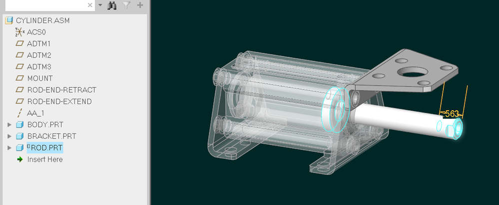

Actually, I still don't quite understand how it all works - I took the cylinder example provided elsewhere in this thread and tried to make it lock up by having the rod's constraints be "shared" between different models, but it still works.  I include it to touch on the "regeneration value" aspect of a kinematic connection - maybe those are responsible for your cylinders "resetting" themselves.
After regenerating, this cylinder will always return to a position where its rod end is 0.563" beyond the bracket's edge.After regenerating, this cylinder will always return to a position where its rod end is 0.563" beyond the bracket's edge.

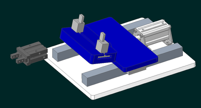

I've attached a very simple reference assembly for you to look at (Creo 4.0). Notice that I have moving and non-moving separated, self-contained, and referencing a common skeleton. The cylinder spans both (body can't move but rod needs to). In this case, I use two constraint sets. One to position the cylinder in the assembly and another to link the rod to the moving body. The cylinder itself needs to be mechanized to do this so take a look at how that is set up as well.

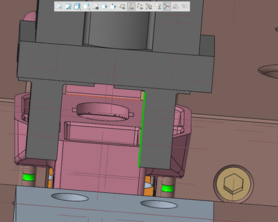

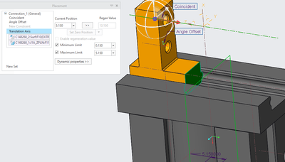

Ok so here is a good example of what I'm talking about.  I have this gripper, using the slider (I believe) constraint system.  The Coincident and angular offset are both planes of the gripper finger to the planes of the first component.  I do this with both fingers.  I use the gear mechanisms to synchronize movement.  Works perfectly as just an assembly.  I throw it into my main assembly and they loose synchronization.
Without seeing your model up close, i can't tell what went wrong.  There can be so many things with this software.
One thing I can comment is I don't use general constraints if a simpler one can work.  For your case, if your gripper fingers are sliding, why not use sliding joints?

Switched to the slider constraints and same issue.
How are you constraining the gripper in the upper level? You can't constrain the gripper assembly via the gripper fingers if they are mechanized. Your motion would get locked down.

I am using the subassembly of the grippers 3 datum planes to the datum planes of my EOAT Plate.

This is the gripper.  I ended up supressing the attached fingers, deleting all the constraints but a fixed constraint and am still having this issue.  It will work fine as an assembly, it only has issues when its a sub assembly in my top level.
I assembled your gripper assembly into a new assembly and the mechanism still functions. This leads me to believe that the issue is being caused by the way the gripper is assembled or the way other things are assembled to the gripper. The gripper fingers seem like a good place to start looking. If they are assembled to the gripper assembly but cut to part data (the thing getting gripped) this would lead to issues with the mechanism. Try isolating the gripper in the upper level. Another thing to look at is whether or not the upper level is mechanized in another level up. If that's the case, you might want to switch the gripper placement constraint set to rigid in its upper level.
