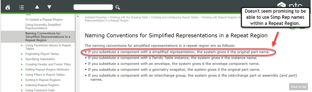

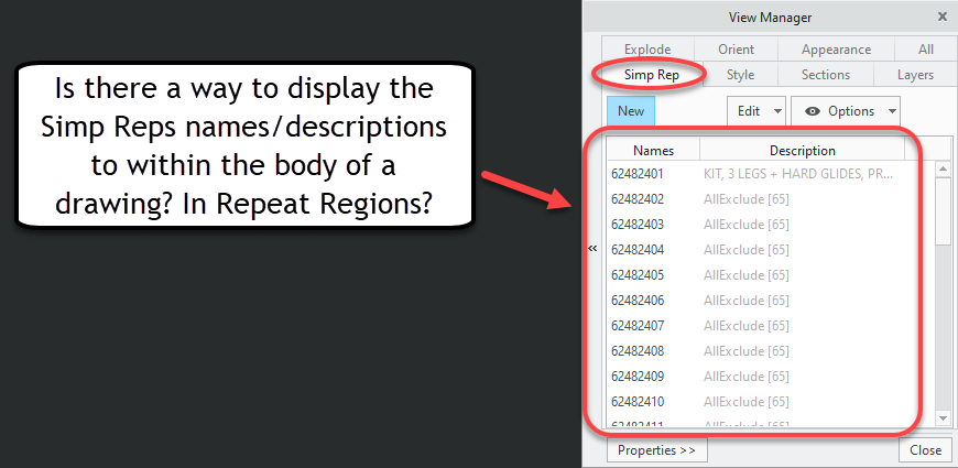

Using Simplified Reps with Creo drawings:
  • Is it possible to display the name/description of the simplified rep within the body of the drawing? In repeat regions?
  • Using simp reps in sub assemblies - is it possible to get drawing Repeat Region BOMs to show the names of the simp rep instead of the name of the assembly?
For repeat regions, It doesn't look promising based on the help documentation.
1 REPLY 1
I am almost sure that requested functionality is not implemented.
