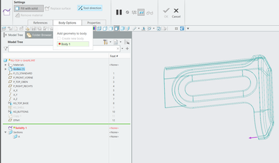

I am trying to fix this regeneration issue where a copied geometry from a skeleton is to be solidified. This is what I am getting:
What could the solution to fix this?

The most common cause for this is that the quilt you are attempting to solidify is not closed. You can also try flipping the tool direction during this feature creation. It appears to me the tool direction for solidify is in the wrong direction based on my interpretation of your screenshot.
If the quilt is open, then you will need to correct that condition in order to solidify it.

Looking at the screenshot, it appears a valid body has not been selected.  You may need to expand Bodies in the tree and select one.
