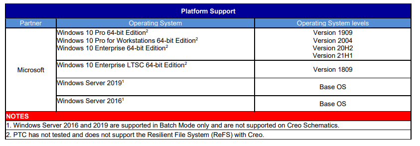

Have you tried a different mouse to rule out a HW issue with the input device? What OS is running on your P51? Creo 8 is only supported on Windows 10.

Sorry - Just now getting into the community to respond.  I think my issue went away with a reboot of my computer.  To be honest, I don't exactly know what fixed it - but it is no longer behaving this way.
