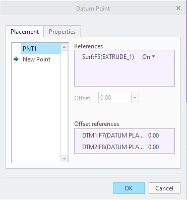

I have a feeling that you have to have the point defined with this scheme (on surface, with 2 offset references):

The point is defined as the intersection of 2 datum planes and the surface on which the weld is to occur.
It is defined within the part in the attached image, but I have also defined it in the assembly itself and that did not change anything. I have also attempted defining each spot weld point as it's own point (in the model tree), rather than a point within a grouping with other points. This also did not change the behavior.

For whatever reason, Creo will not accept a point that does not use offsets.  Try changing your point to be on the surface and offset from the 2 planes by 0.

IF I use offsets like you've shown, it does work.
