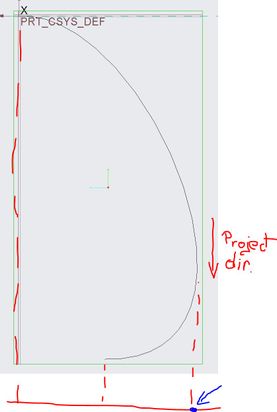

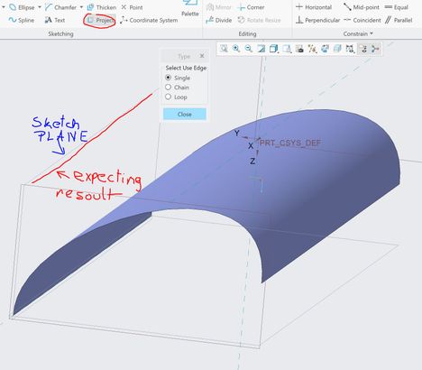

I have simple surface as shown below and trying to do simple operation to project to plane.
Any idea how to do that ?(i'm solidworks user and trying to switch to creo 🙂 )

First, you tagged this as Parametric but the help link is for Creo Direct.  Here's the link to the project command in Creo Parametric:
http://support.ptc.com/help/creo/creo_pma/usascii/#page/part_modeling%2Fsketcher%2FAbout_the_Project_Command.html%23
That said, in order to project a silhouette edge you need to be in sketch orientation or Creo can't "see" the silhouette edge.  Creo cannot project a sihouette edge from a lofted surface that would end up being a pline, but in your image, it looks like you dealing with an extruded surface so it should work.  Put the model in sketch view orientation first and try again.

It is working on that simple example but finally i want to use project - surface operation on "swept blend" feature and it is not working ?! strange cos that is preaty basic cad operation 😞
