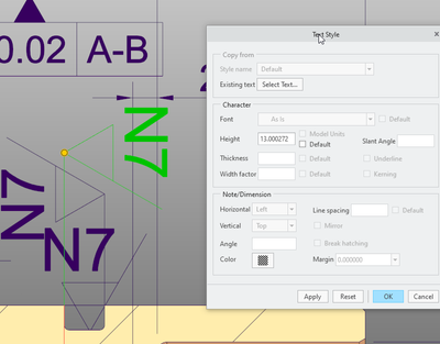

Hello
In our Creo (Creo Parametrics 8.0) 3D environment, the text size of surface symbol cannot be changed.
If I open the text style menu for the surface symbol, the value is set by 13.000272.
Now I can insert a new value, force Apply or OK, but the size does not change.
If I open afterwards again the text style menu, the 13.000272 is back again in the cell.
Does any body have a hint how to change it after creation of the symbol?
The surface symbol is applied by the use of the Annotation, Surface Finish feature.
Here I find as well this value for the Height 13.000272.
Thank you in advance for inputs.

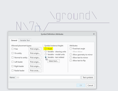

Pius
(To:Pius)
Hi
Don't know whether this is of interest, but the problem is solved.
Our surface symbol was set-up as fixed.
The solution was to define the symbol as Variable - Either to drawing units, model units or text related.
I'm using text related for this case as the feature contains text.
hope you can use the information ones you come to MBD.
