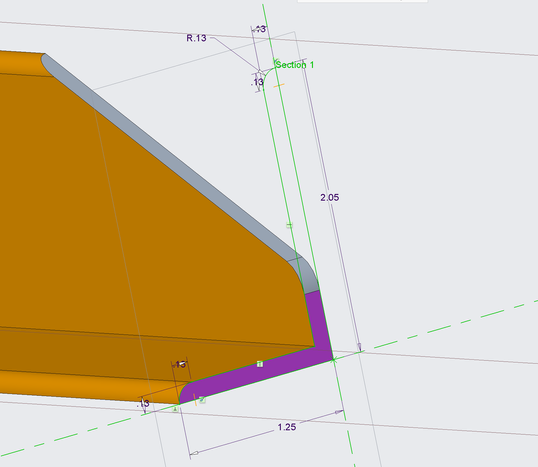

Hi guys,
I can't editi the profile of the part I modeled. I want to adjust the radius, but it behaves funny. Plus I can't even delete this line to redraw.
Does it mean I have to redo the part?
Thank you for your help

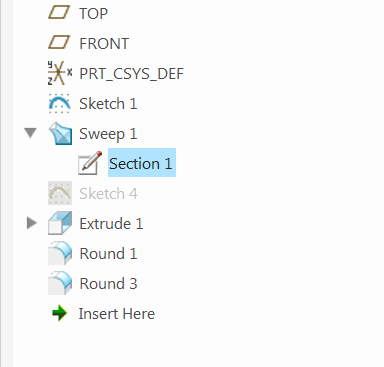

No. There's no mirror feature. When I right click on the Sweep 1 - Section 1 it doesn't give me an option to edit definition.
Is that just a specifics of the Sweep in Creo?

However, I don't believe you can access the sketch of a sweep (other than editing exiting dim values) directly from the model tree.  Right click on the sweep itself and then click the sketch button on the sweep dashboard to access the sketch.

I finally got it. I had a different mindset in this case. Logic of Creo is completely different from what I'm used to. So it's an interesting challenge.
Here is how you edit the sweep sketch.
Edit Definition of the Sweep itself >> hit "create or edit sweep section11062017_1.png
